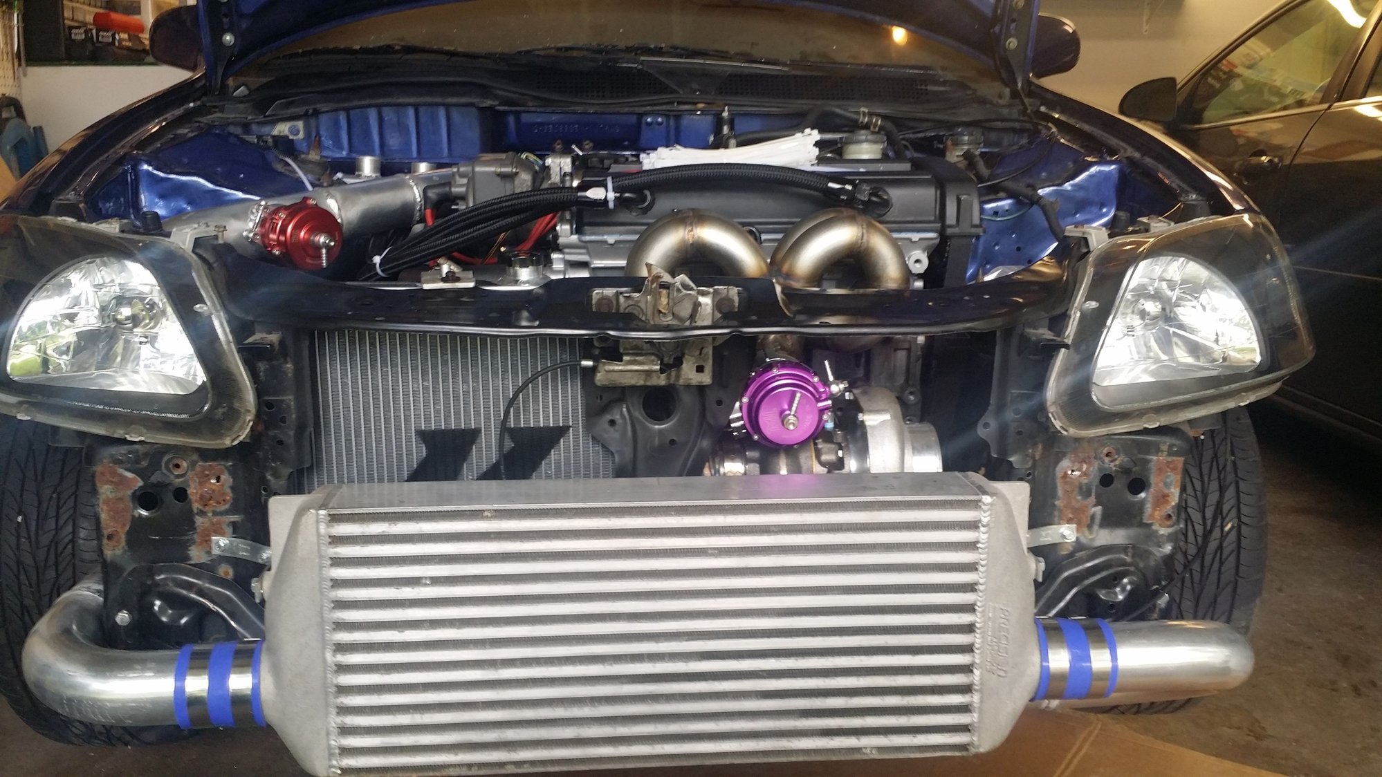

Post a pic of the manifold and how the wastegates are placed
I would take the wastegate off if its not too gard to get too and put 18psi of pressure on the bottom port and see if the valve opens

  #83
jarrodsi's Avatar
Joined: Sep 2011
Posts: 110
From: Ft Wayne, IN
Default Re: dyno results
