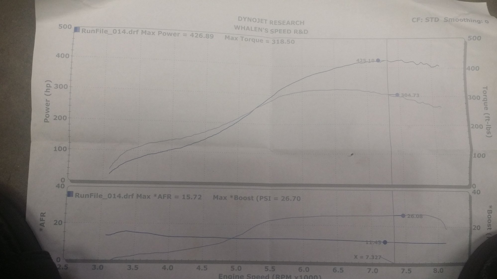

MMM I'm trying to think why your motor didn't blow. I tune to 11:8 afr on e85
Old Sep 22, 2015 | 02:48 PM
  #27
Aradin's Avatar
Premium Member
Posts: 1,968
Likes: 188
From: Maryland.
Default Re: dyno results
Well the timing curve is gradual and not all funky/choppy looking like I've seen on bad tunes in the past. I'm not really familiar with that level of boost/power but for E85 that timing seems very, very, very relaxed. I'm running more timing on a stock 10.6:1 CR H23 on pump/meth. Your AFR appears to be an issue as well, assuming it's not a mistake on the dyno sheet you posted.
Do you have a wideband hooked up? I'd be interested to see a datalog of a pull.
Originally Posted by NotARaCist
<p>I don't know enough about E85 to know...is 15.5:1 really a good AFR for that fuel?</p>
That is displaying max afr for the run, probably before he rolled into the throttle.
Op what are your afrs under full boost?

<p>
Originally Posted by turbohatch96y7
Yeah no **** 15.5:1 has to be a mistake.
</p><p>Yeah, and if it isn't a mistake, it explains why his power is so ****.</p>
the timing looks really low
Yes a 6262 is absolute overkill for the power you are making. Something like a 5858 or 3071/3076 would make the same power with a much wider powerband. This is yet another example of Honda owners severely oversizing turbochargers which is something I'll never understand.
But yes you have a serious issue somewhere. Those pressure levels using a 6262 on a healthy setup should yield much much higher power numbers, like 700+. Either your tuner is the problem or it's something like the cams aren't properly degreed/cam gear timing is incorrect, you have a head gasket or ring seal issue, massive exhaust leak pre-turbo, or a huge vacuum/boost leak.
Cam specs
INT/EXH
Ad. Duration: 308/303
Dur @ .050” Lift: 216°/214°
Gross Lift: 11.3mm/11mm
LSA: 109°
RPM: 1100 to 8200
Redline: 8700
Crower describes these as aggressive NA cams. Depending on how much overlap they have that might be part of your power issues or the main cause. You might need to play around with using the cam gears to dial out some overlap. Granted the stock ports aren't helping you any at this kind of power level.
Have you done a compression and leak down test? That will show the health of the engine and could show potential issues like poor ring seal, poor valve seal, improper cam or mechanical timing, and so on. What is your base timing set at? Is that value syncd to the ecu?
You have enough fuel pump and injector to support much more power than you're currently making but have you checked your fuel filter to see if it's clogged? I'm assuming your base pressure is properly set?
You need to start going over every aspect of the engine, turbo system, and engine/fuel management.

That's the dyno sheet from my tube so it has to be what they set it at. I'm going to do a compression test and leak down tomorrow my base fuel pressure is at 30psi.
No tuner in their right mind is going to target 15.5-1afr in boost. Do you have a wideband in the car? If so what are your afrs in boost?
I could go check my afr is in boost but I'm kinda iffy about getting into boost now
Just let off if it's lean in boost. I highly doubt your actually running 15-1afr in boost, idle and cruise maybe, but not boost. You should data log a couple pulls.
Go into the s300 menu and find the boost cut setting. set that to the lowest psi you can
lower your boost as much as you can and do a couple runs and slowly bring the psi in watching the afr or datalog it and check.
should be in the 11's

Agreed. Go do a light throttle pull in 5th gear and watch your AFRs close as you get into boost. If it looks lean just get out of it. I suspect your tune has something to do with the lack of power. Your timing looks way too low to me, especially for your setup and fuel.

This is my actual dyno sheet the picture I had up before was the screen at the dyno. Showing my af in boost is 11.43 and continues to go down when I hit 26lbs
Thats better lol
My bet is on cam or mechanical timing
