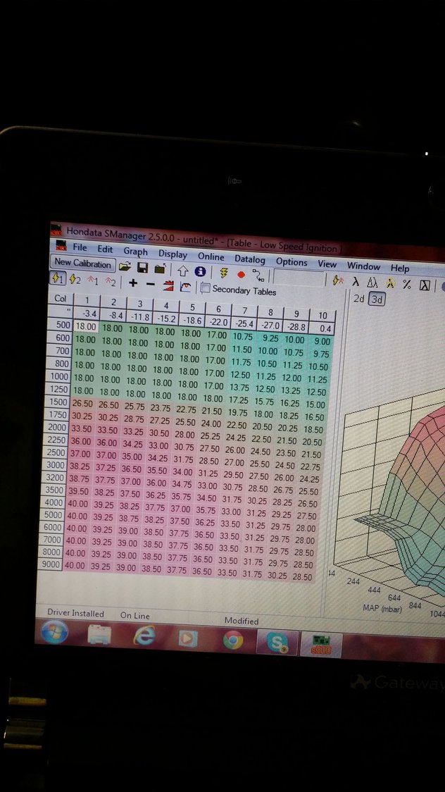

Old Sep 22, 2015 | 02:02 PM
jarrodsi's Avatar
Joined: Sep 2011
Posts: 110
From: Ft Wayne, IN
Default Re: dyno results
Low speed ignition table
Sorry if it's a crappy picture

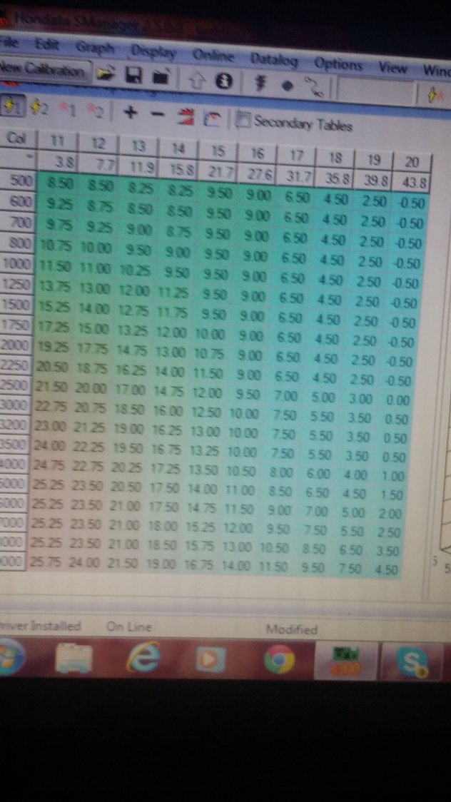

Old Sep 22, 2015 | 02:03 PM
jarrodsi's Avatar
Joined: Sep 2011
Posts: 110
From: Ft Wayne, IN
High speed ignition table

You need to select show 3bar in the drop down at the top. That will show us the timing values when in boost.

Old Sep 22, 2015 | 02:26 PM
boosted94gsr's Avatar
Joined: May 2008
Posts: 1,892
From: Southern Oregon
We only need to see the low speed ignition table as the high speed is not used on your nonvtec motor.

Old Sep 22, 2015 | 02:34 PM

<p>I don't know enough about E85 to know...is 15.5:1 really a good AFR for that fuel?</p>

Yeah no **** 15.5:1 has to be a mistake.

That's what he tuned it at I defiantly told him I was running e85.

Other half
Now you need to move the center slider over so we can actually see the boost columns.
