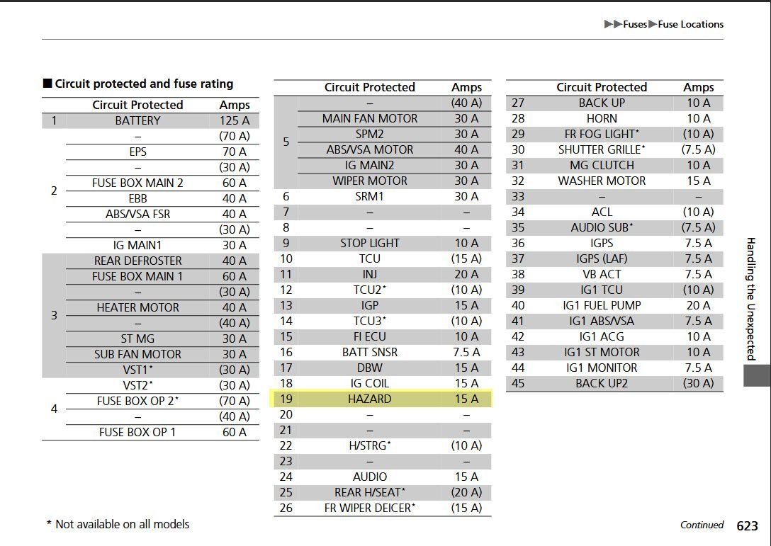

Thank you for your help, I will get a fuse today and try, which fuse is A19? Amazing all of the people wanting to sell me a relay told me I needed that part. I hope this works, hate not having turn signals.
Old May 11, 2026 | 06:25 AM
tech8's Avatar
Global Moderator
Loved
Community Favorite
Posts: 6,089
Likes: 524
Default Re: Help with flasher relay
