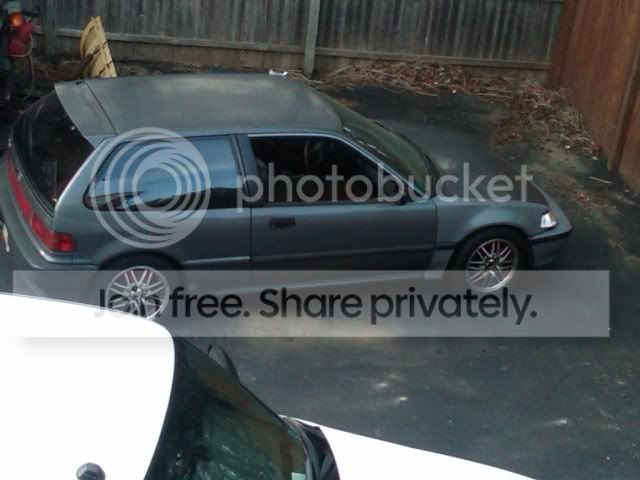

i am undecided on what car i want to put it in. its currently in my built hatch that my z6 vitara build was in till it gets fixed.
my hatch
My Sedan(under construction)
the sedan was originally suppose to have the LSV swap but i lost my job and then lost interest in rebuilding it. mostly needs body work and paint. has new manual steering rack(bought from sum site to convert from power steering), integra front knuckles/brake swap, had a rear discs but put on hatch since i didn't drive the sedan, converted to obd1(mono-tech harness). Im still debating on junking it or trying to sell the shell for cheap.
