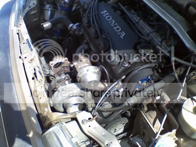

d16a6 block/stock rebuilt z6 head
eagle/75mm vitara bottom end
arp headstuds yadda yadda
stock IM/tb
autoworks log mani

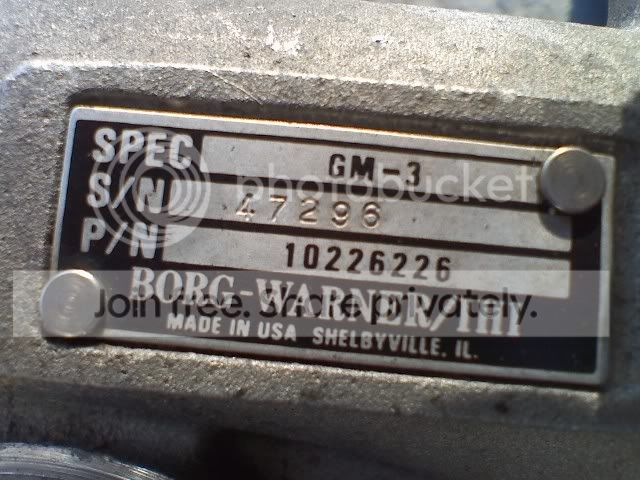

BW GM-3 same as gm1 i believe, think 1-9 are the same turbo but with minor housing differences... dont quote me on that tho.
3" dp, and about 20psi.

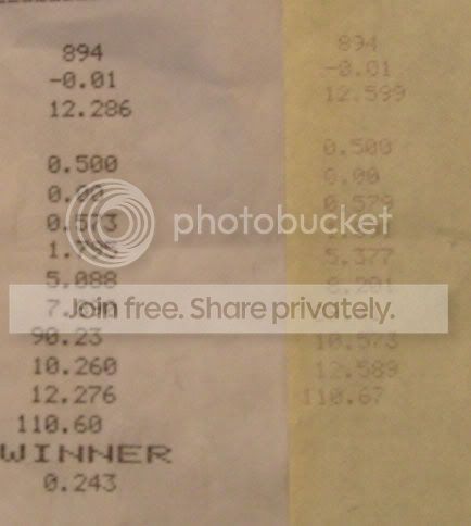

the turbo didnt really wake up until i ran over 12psi with it, the thing kicks hard at 20... i love my $140 used turbo.
fmic, painted black, no telling whats in store.
during instalation
car 894
