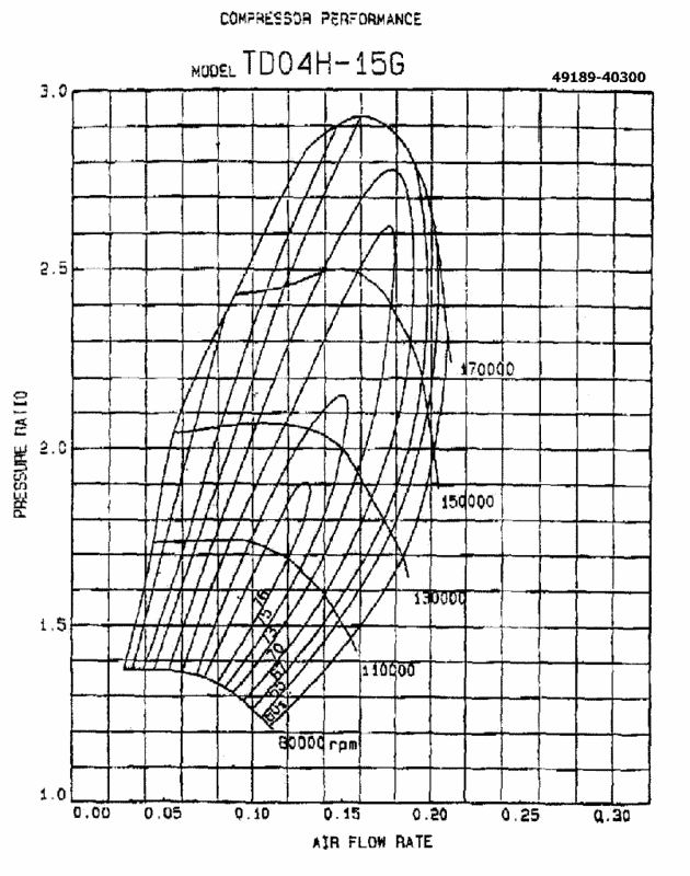

No. To get even about 270whp on the D series motor, the turbo needs to be efficient at over .28kg/sec even at 7500rpms at over 15 psi of boost. this turbo is capable of less than 35lbs/min on the compressor wheel. It really wouldn't be possible effectively to get 300whp out of this. Here's the map for you as a reference.

<TABLE WIDTH="90%" CELLSPACING=0 CELLPADDING=0 ALIGN=CENTER><TR><TD>Quote, originally posted by elcangripapi &raquo;</TD></TR><TR><TD CLASS="quote">So does anybody else have any helpful input? Possibly a flow graph for a 19t? I understand that the 15g may not reach 300hp. But I still want to know the diff between the two turbos.
Wantboosts posts were o-so insightful...</TD></TR></TABLE>
kg/sec and multiply by 132.177 for lbs/min

34.36 lbs/min and thats tapped out. keep in mind that would be 340crank hp at max.. it would get you closer to 300 but not all the way there. and thats assuming 100% ve out of the motor
