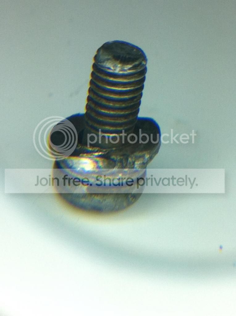

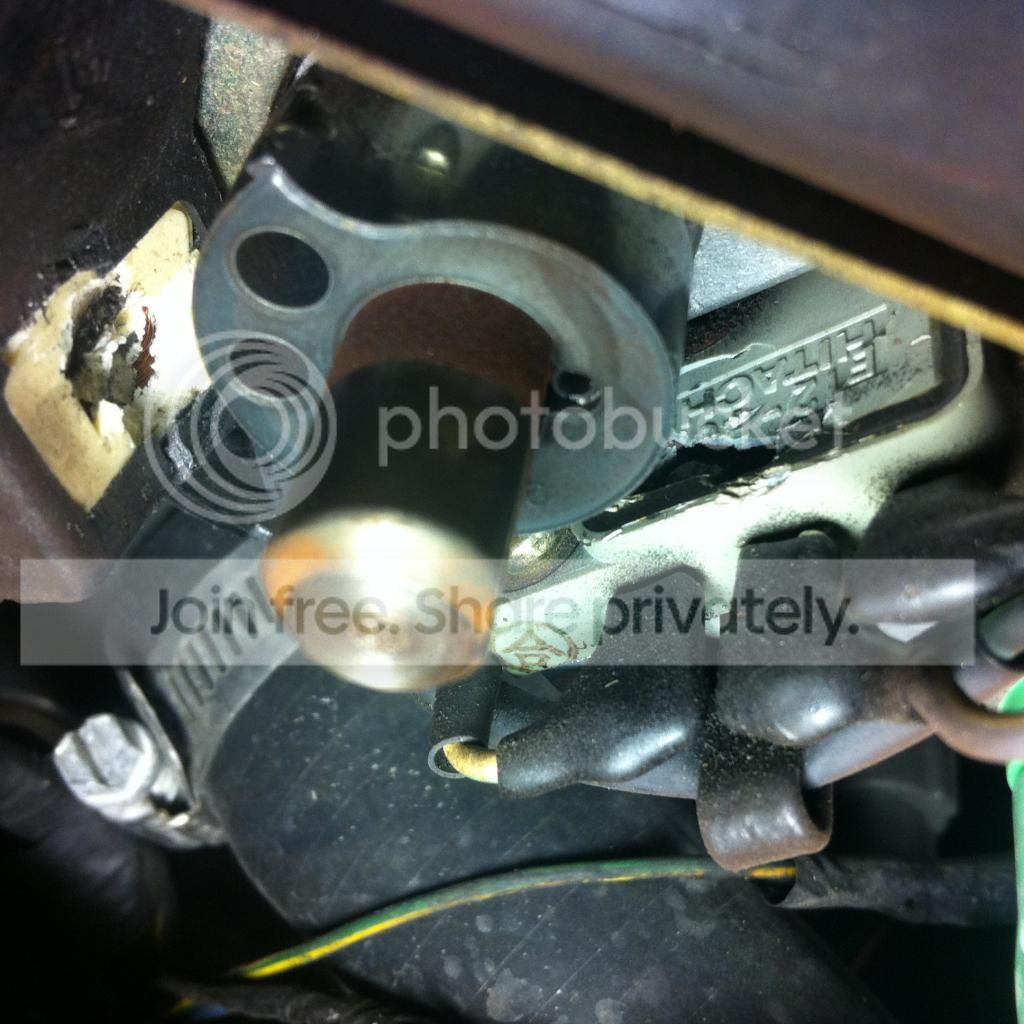

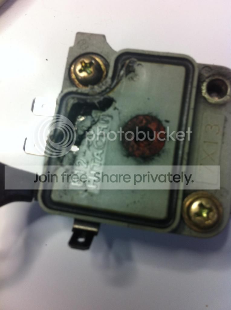

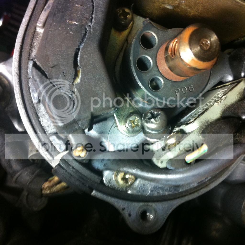

I think maybe I found it.
Opened up my dizzy tonite, (I know...3 months later,but I'm ******* busy, and car was slightly ok) and found this. Note rotor screw in wrong position.
The culprit
Trapped 109 Saturday on NeoGens (first time down a track) like this. Had to leave easy, stock mounts and it's spitting the axle out.
It was running ok...stumbled a little at stops sometimes, died.
Put it back together w/these parts after removing the screw...cuz it's my daily.
It idles better now with a screw in the rotor.
Damnit, this was a good dizzy...imported from Cali.
Gonna need some parts if anyone has 'em.
Need to repair this and hopefully it will fix the CEL.
