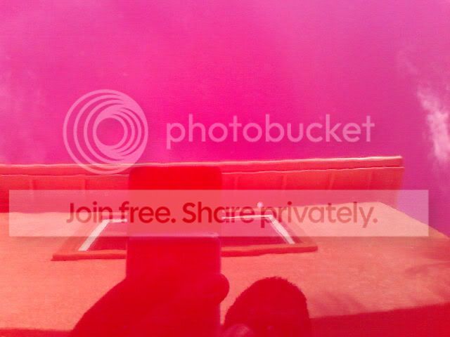

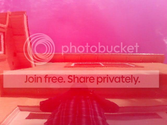

just wanted to share some pics... I followed NOFX instructions
nice write up by the way

you should post up some direct sun pics.
