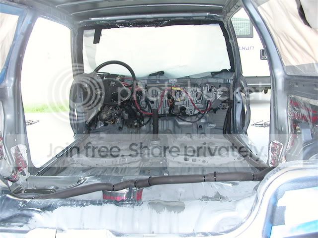

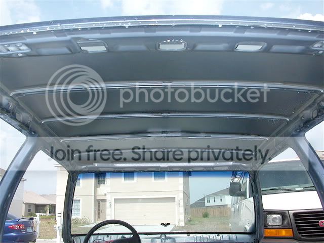

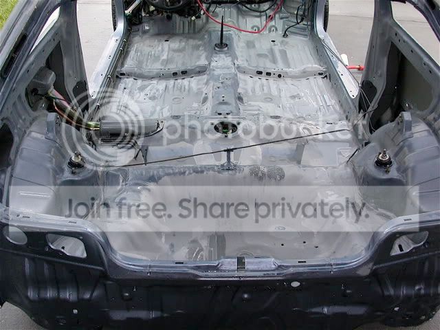

update-friday, saturday and sunday are reserved for paint so i'm getting everything ready.
i have 2000+ sq.ft of plastic and about 3.5 quarts of paint. soaked the hvlp gun in thinner and now it's nice and clean.
I removed everything that i'm going to remove. wetsanded the interior and door jams with 400.
refrigeration line insulation was used to cover up the shifter and the brake lines because it was quicker than taping it up.
