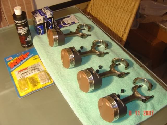

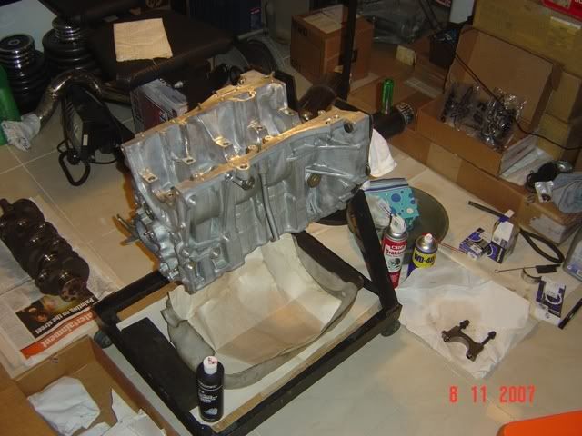

bump from the dead. it's been quite some time this project was at an idle state.
...still thinking on how to install these supplied piston pin spiral locks

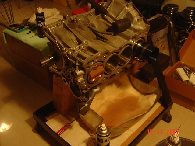

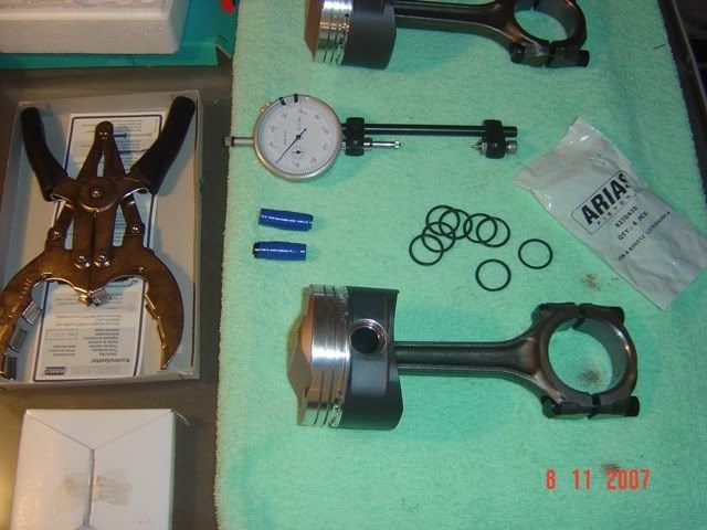

another weekend progress...
those piston pin spiro locks were a pain to install but it made me think after looking at this expensive special lock-in tool.
http://www.lockintool.com/how-to-use/
it's fun installing them btw, after i got the hung of it the third time, installing them was a breeze, took me 2-3 minutes per lock using just a shorty flat screw driver. no mess, i was totally astonished it's that easy, no need for that expensive tool
finally installed the pistons into the block.
last one to go,
sitting pretty in their new home:
checking piston-to-deck height.

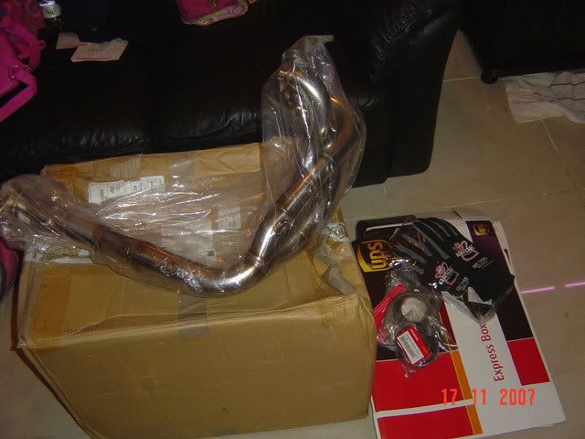

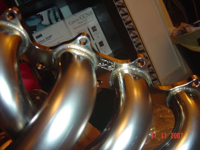

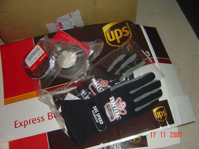

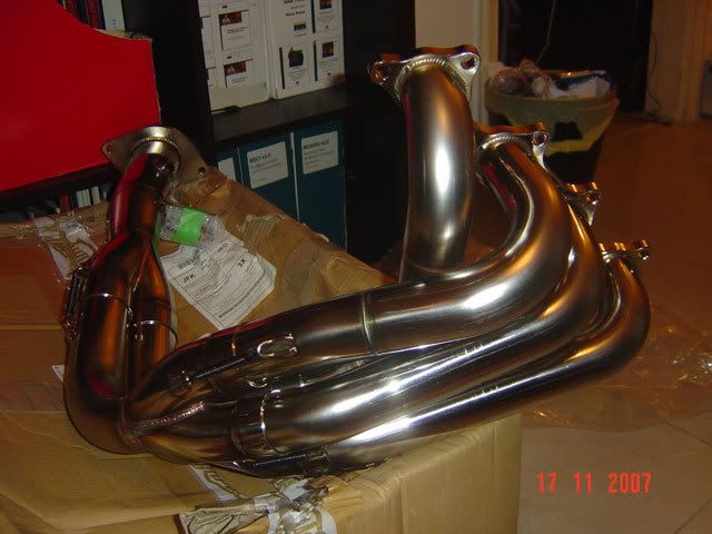

some early Christmas gifts

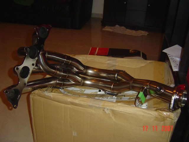

damn i just went through your entire thread and you ef is baller. how much did that header cost you?
Old Nov 17, 2007 | 08:17 PM
  #190
ef92b's Avatar
Posts: 1,073
From: Mid East Deserts
Default Re: My Build-up (bigluelok)
<TABLE WIDTH="90%" CELLSPACING=0 CELLPADDING=0 ALIGN=CENTER><TR><TD>Quote, originally posted by bigluelok &raquo;</TD></TR><TR><TD CLASS="quote">damn i just went through your entire thread and you ef is baller. how much did that header cost you?</TD></TR></TABLE>
thanks for the time man. got it for $980 + $48 shipping from jhpusa. oh well, that's after a year saving since i never got my RMF Narrow.

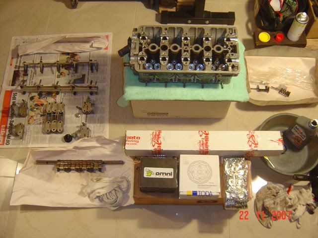

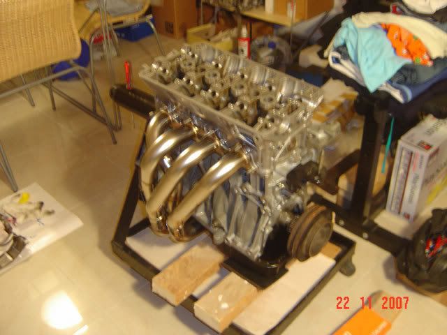

just did some test fit on the header to see the ground clearance with the oil pan as reference.
can't wait to degree these cams in.

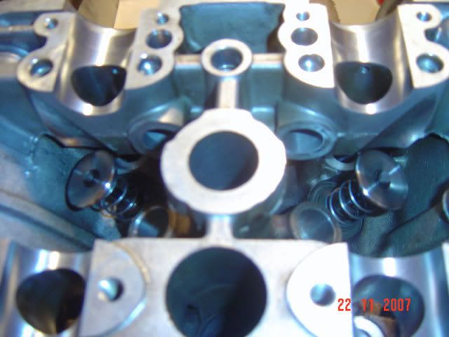

Mike Belben's test valve springs fits snugly with Bisi's ti retainers.
springs and ball bearings came with this kit:

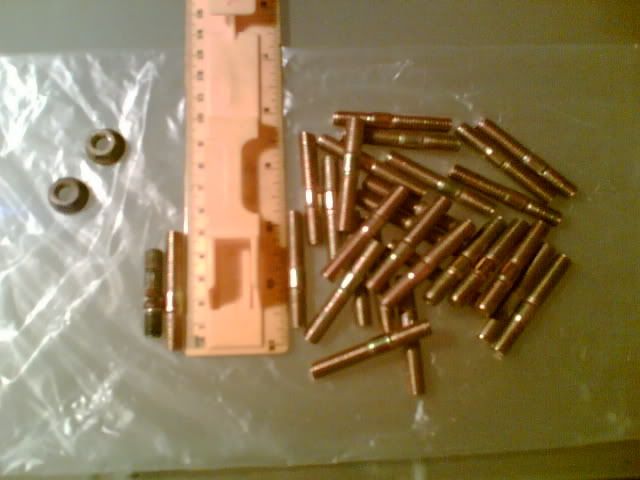

test fitted the Hondata gasket some time last month and the studs where quite short.
got some replacements just last night. studs in 50mm length. 12mm longer than the OEM ones.

looks sick with the header on
