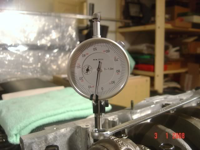

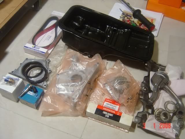

now back to my homework. finally got some chance working on the buttom end once more.
picked up my con rod bolt stretch tool and did some work.
rod bolt/s tightened and stretched from 0.0053"-0.0057".
after torquing mains and rods, i did check the crank and rods' end play. so far within specs (0.12mm) using the new ACL thrust washers that came with the bearing kit.
new parts(pumps, seals, etc.) ready to go:
almost there with the buttom end:

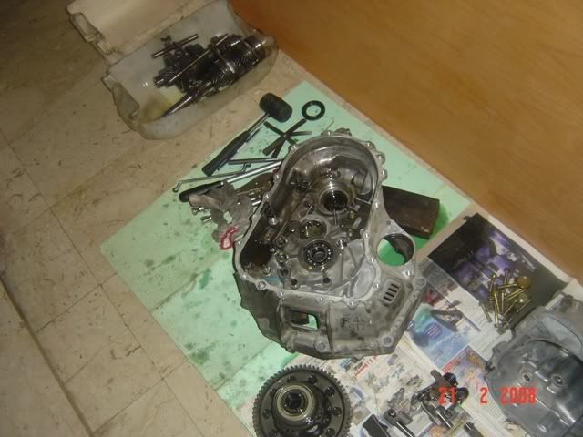

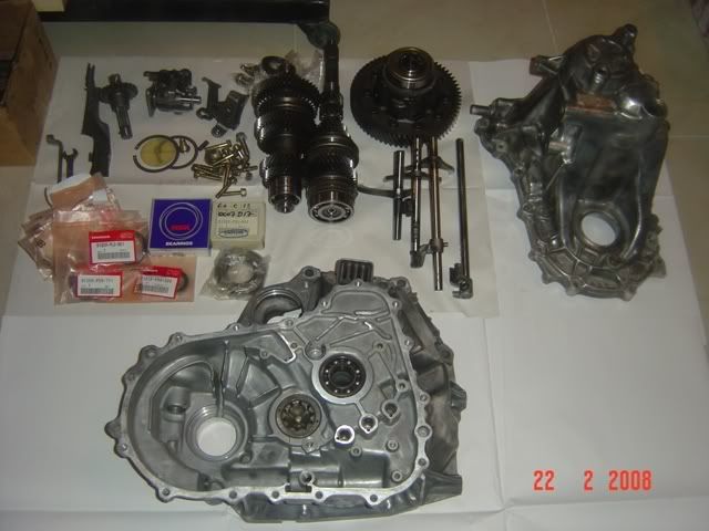

bump for some updates:

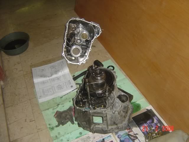

building my hybrid tranny. Hydro S4C LSD/CTR tranny into my cable LS YS1 tranny.
all's clean, ready to swap the fifth gear off of the LS.

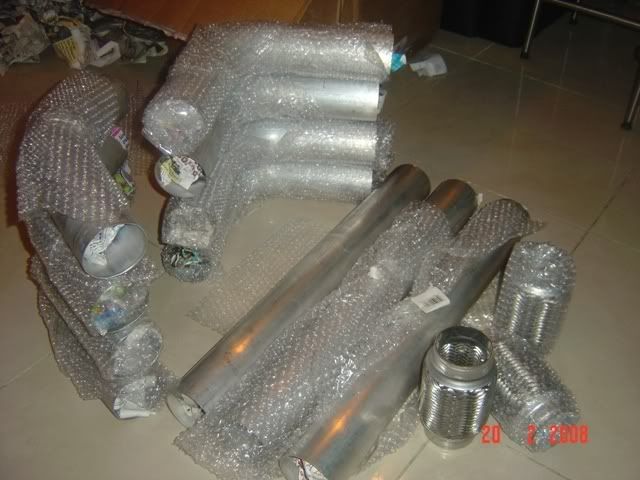

some extra aluminum pipings to construct a custom intake. others for sale

snap! hehe u started ur tranny work...
hmmm i see sum mandrel bends and flex joints.. hmmm

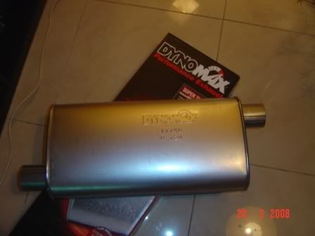

was doing couple more measurements with the block and head.

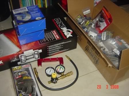

tools and more parts arrived finally.
Dynomax chambered muffler with 2.5" inlet and outlet.

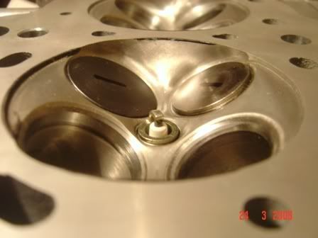

with those humongous piston domes, i opt to measure piston to deck height and quench pad depths. finally making use of my new tool from Proform.

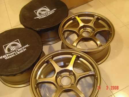

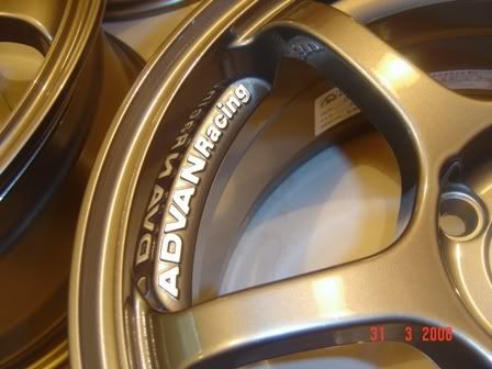

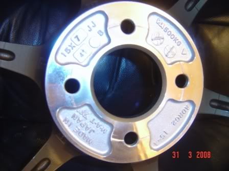

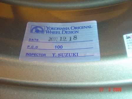

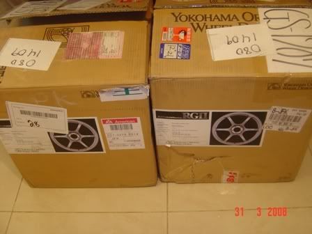

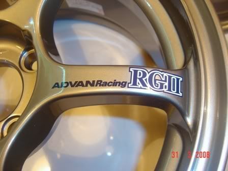

ask and you shall receive. LOL

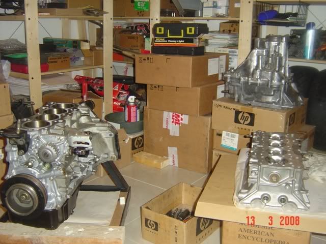

after so many months of waiting... from the land of the rising sun, i finally got them
