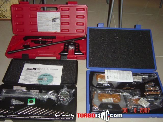

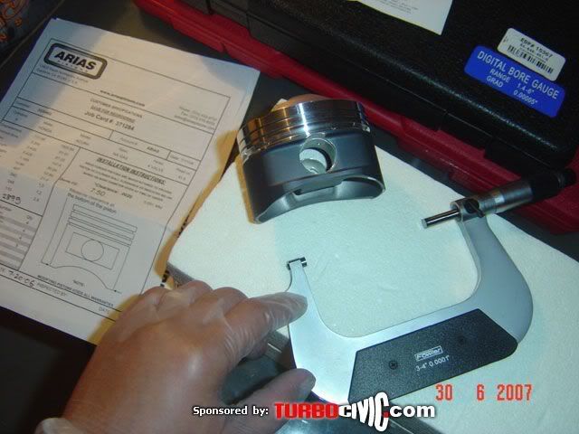

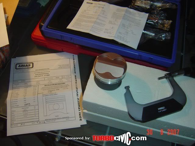

time to work once again. I just received my new precision tools yesterday night shipped from the US. A universal valve spring compressor, digital bore gauge(0.00005" graduation) and a vernier micrometer(0.0001" graduation). I always wanted the Mitutoyo tools but i cannot afford them for now. I believe this Fowler tools will do it's job considering its graduations. I love investing on tools as the work progress.
I hope to assemble the buttom with in a week or two after dropping the block for a rebore and hone to cater my new OS slugs. i prefer using my own tools to double check clearances rather than sorry.

placing the good tools into use.
I'm getting some baseline measurements of all my rods'clearances before dropping them off at a local machine shop for the bolts replacement and pistons install.

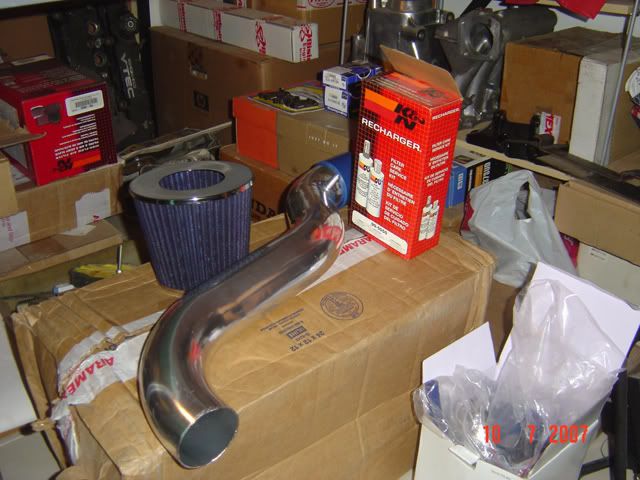

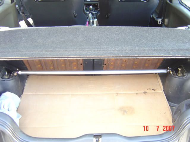

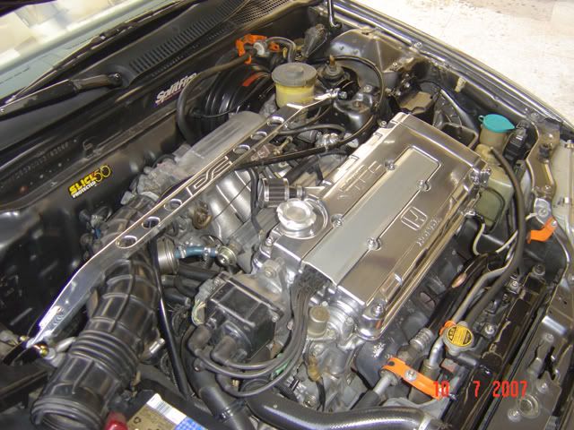

while waiting to drop my block this coming weekend, i installed some few basic stuff.
using some e-gay shock tower brackets mounting my old DC strut bar:
some el-cheapo's at the rear:
basic intake upgrades:

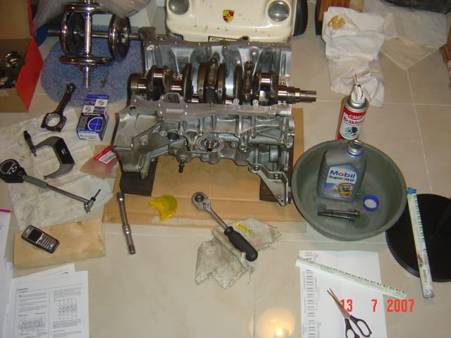

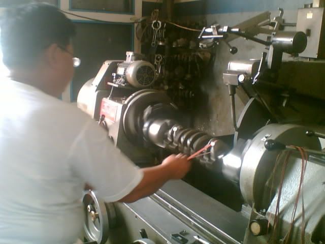

got my crank worked on at the clinic:
getting the block re-bored: sorry for the crappy vid, it's from my phone's camera
crank being micropolished:
checking my crank clearances after the machine work:

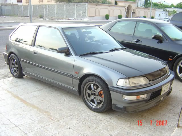

Old Jul 15, 2007 | 12:20 PM
  #167
ef92b's Avatar
Posts: 1,073
From: Mid East Deserts
Default Re: (wrinkles)
<TABLE WIDTH="90%" CELLSPACING=0 CELLPADDING=0 ALIGN=CENTER><TR><TD>Quote, originally posted by wrinkles &raquo;</TD></TR><TR><TD CLASS="quote">ive been following the build and i wanted to tell you i think your car is beautiful! i was wondering what the color is called because i really like it and was considering it for my car</TD></TR></TABLE>
thanks man.
the OEM color is Pewter Gray Metallic, NH-537M. a bit darkened though.
took a snap of her today btw.

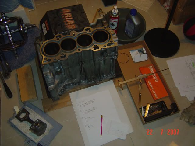

still doing piston rings end gaps.

deym, i'm in need of a piston ring filler tool. got to resize the end gaps to my specs.

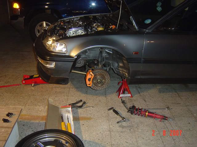

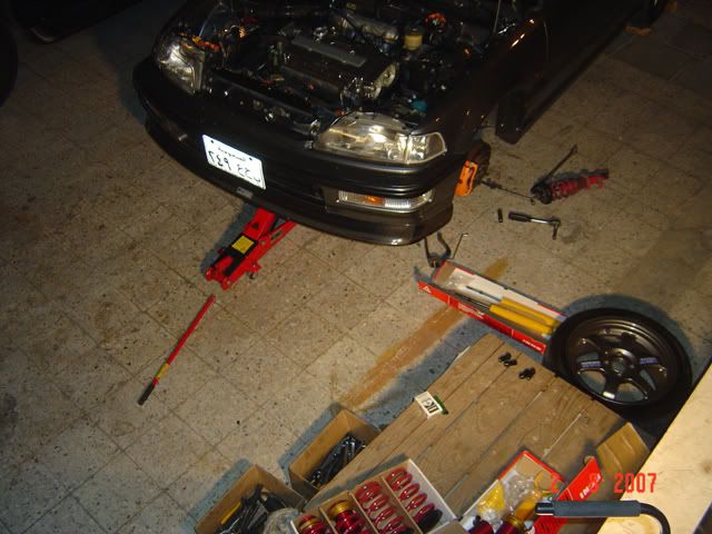

just a little update. installed my new suspension stuff.
