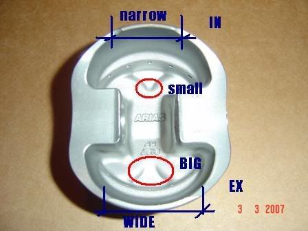

hey...check this out.
Just got an E-mail from Arias:
"The intake valve relieves are under "ARIAS", when you look in the
underside
of the pistons, the name ARIAS is engraved on the forging, the side
where
ARIAS is located will be the side with the intake valve relieves."
i just had to confirm!! because i was scared!! ;D
Dude!!! i took my oil pan off!! and my arias logo is on the EXHAUST SIDE!!
Modified by gsrcrazy at 8:43 PM 5/15/2008

check this out aswell...tell me what you think.

wow..i've been waiting for you to get online!!
im about to completely install my engine in a couple of hours..but for some reason this was bothering me.. so i kept searching and searching...... and i finally found this link...
https://honda-tech.com/zerothread?id=871322&page=1
Old May 16, 2008 | 02:04 AM
  #282
ef92b's Avatar
Posts: 1,073
From: Mid East Deserts
Default Re: (gsrcrazy)
but now am totally lost since the intake side has deeper valve reliefs
if this pic is true, narrow intake skirt vs. wider exhaust skirt, them i have to redo all the stuff then

check this out..from that same thread i found..
UPDATE: e-mail
"If you measure the vertical depth they will be deeper.
The exhaust relieves have a 15° angle on them.
Once again, the valves that appear to be closest to the edge are the exhaust valve relieves."
Modified by gsrcrazy at 3:13 AM 5/16/2008
Old May 16, 2008 | 02:18 AM
  #284
gsrcrazy's Avatar
Posts: 368
From: SoCal, California, United States
Default Re: (ef92b)
yea.. i am completely satisfied that this is how they go... you could actually feel the bigger valve pockets (reliefs) from under the piston! lol

<TABLE WIDTH="90%" CELLSPACING=0 CELLPADDING=0 ALIGN=CENTER><TR><TD>Quote, originally posted by ef92b &raquo;</TD></TR><TR><TD CLASS="quote">but now am totally lost since the intake side has deeper valve reliefs
i think that to the naked eye... the ex. valve reliefs seem bigger because they have more of an angle to them... not necesaraly deeper.. like it says in the email.
yup!
just went over the thread you posted while am looking at my piston pics (high resolution) and seems that you are definetely right. thank God i haven't completed mine yet.
