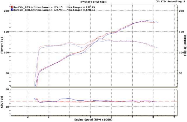

I did have my GSR manifold runners PnP'd a bit.
Some Pics
The gains with manifold change on stock GSR cams.
Most of the gains came in the mid range. Made the car really fun.
Tuned on a Hondata S300 in a P72 ECU with IAB relay.
I am waiting on my New V2 GSR manifold. Flows over 300cfm and still has IAB.
