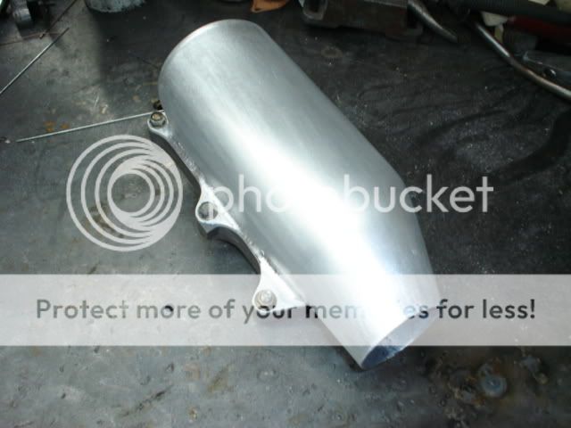

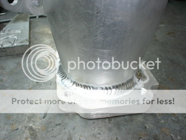

I saw this one a while back.I think its Ericks Racing's.
I found some more pics of it.Call Erick he has two of them .The other one is a little bigger than this one.

Erick's racing right

<TABLE WIDTH="90%" CELLSPACING=0 CELLPADDING=0 ALIGN=CENTER><TR><TD>Quote, originally posted by need longer days &raquo;</TD></TR><TR><TD CLASS="quote">I saw this one a while back.I think its Ericks Racing's
B16 head

<TABLE WIDTH="90%" CELLSPACING=0 CELLPADDING=0 ALIGN=CENTER><TR><TD>Quote, originally posted by Fabman &raquo;</TD></TR><TR><TD CLASS="quote">Erick's racing right </TD></TR></TABLE>
Randy from RMF made that, no? Or you? I've seen it before but I can't remember who posted it.

can they be purchased?? suppose i could call them

So that manifold has the butterflys and plenum removed and replaced with a bigger plenum? That's a B16 head? Hummm....
