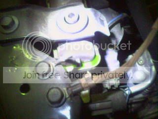

Tonight I noticed something evaporating from under the hood. Took a look under there and there is coolant leaking from my radiator. It seems to be spilling over from the top or something. The coolant bottle is empty. I'll get more coolant tomorrow but obviously this won't fix the problem. The car is not overheating, which is why I didn't notice the problem until tonight.
Recently I've had to park my black car outside in very baking hot california sun and then drive it with the AC on. Could this have anything to do with it? What could be the problem and what could have caused this?
I'll have pictures up soon.
Edit: Here are pictures. Sorry about the quality, it was late at night and taken with my cell phone.
Front of radiator
Passenger's side
Driver's side
Small puddle of coolent in the engine bay splash guard

the ac has nothing to do with it... they usually crack or leak at the seams ... a way to prolong the life of your radiator is to do a simple drain and refil of your radiator every year .. it really makes a difference
this radiator isnt too expencive about 100 or less .. buy a koyo oem replacement they are good quality

the radiator leak fix will come loose, it's not meant as a permanent fix, you should only rely on it for a month or two. I would hook up you up with like a $100 oem replacement, but my parts place doesn't have any GSR's right now. Know of any local shops that can soft soder?

at 100k miles my radiator's top plastic tank cracked (2" wide crack) and the seal where top plastic tank connects to aluminum core leaked after i revved to some 6000 rpm in 1st and 2nd. it's a common thing for our cars at 100k miles to bust out the radiator. i epoxied the crack (epoxy didn't hold up very long because of the pressure of hot coolant and flexing in the cracked plastic), but i also used this leak-stop powder thing and that held the coolant from coming out of the seal and partially out of the crack. ended up getting oem replacement for 100 bux some 3 months later

OEM radiator is fine if you're on a budget, and don't have crazy HP goals in mind. However, it will break again, so why not just pay like 350 for a nice Fluidyne.

common problem in G3 tegs my friend. my oem rad crapped out on me last year and the same leakage problem you're having. the plastic on the top of the rad goes bad over time, i suggest buying an OEM replacement from like http://www.radiators.com they work fine and very inexpensive. mine was $118 shipped. They're not hard to replace either, just takes time. You could also invest in all metal radiator as well from that same site... theyre a bit more but, the reg OEM replacement is a good buy...good luck
