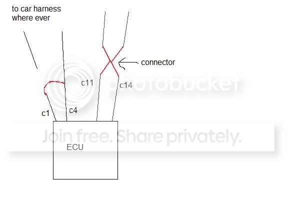

One quick question after I read over the DIY. I cut C1 all together. Take the C1 and put to C4. Than put C11 and C14 together or cutting C11 and putting to C14?

C11 and C14 have to be grounded from the ECU, so you can safely connect those 2(4 wires in total once you cut) to each other.
C1 needs to be cut a few inches from ECU(blue wire), and from the ECU it should only touch C4. Not the other end of itself that you snipped.
Make sense?

Here's a picture of what I think is going on, lol.
Now you say blue wire which is C1 but from the ffsquad picture c1 is blue/red and c2 is blue

Perfecto. Use the pinout if you are unsure of colors.

Just wanted to follow up. Just did the bypass today and so far so good. Hopes this helps someone in the future
