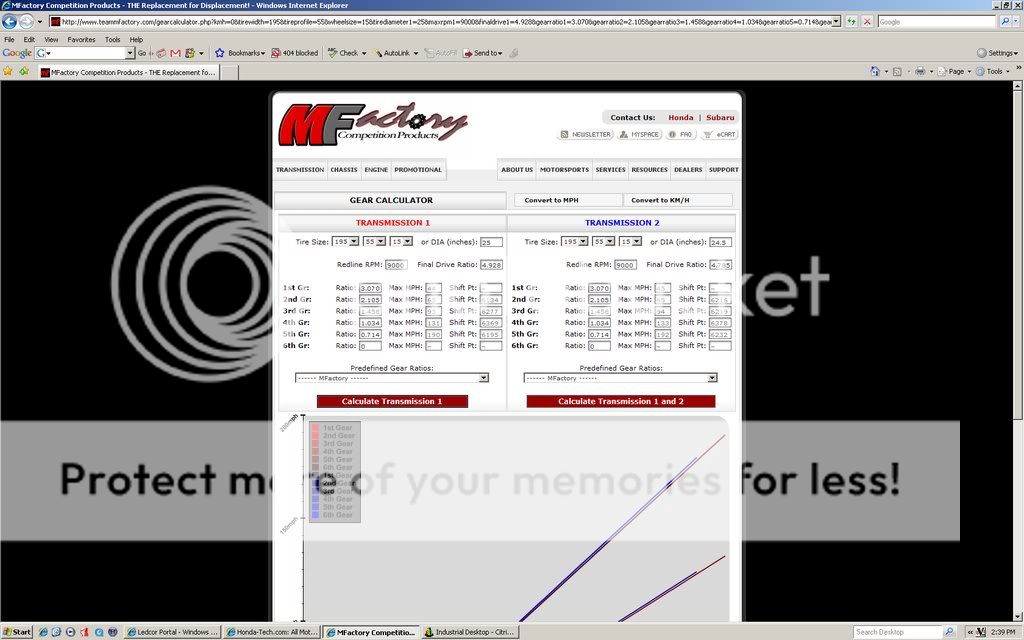

It will be worth your while to play with this for a while
http://www.teammfactory.com/gearcalculator.php
Just a hint, the 98 spec type r tranny is pretty close to what you want to be running... but it's incompatability with alot of aftermarket parts and other B-tranny;s make it a bad place to start if you want to build a hybrid
you can also use this to calculate your RPM drops. it's very helpful when you're trying to determine gearing and where you want your shift points to be.
http://www.wallaceracing.com/R...r.php
Good Luck!

what do you think of these??
They are
Mfactory 1st,
B16 2nd / 3rd
GSR 4th (or type r 2-4)
and LS 5th
/w 2 options for final drive and tire sizes
any opinions on these??

Look at the gear charts I posted, it's all in the numbers.
