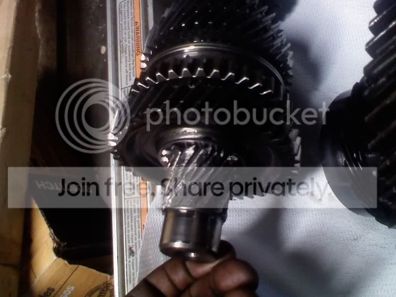

thanks man i recently stripped my final drive imma change up a few things mfactory here i come lol
