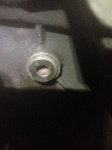

Well I bought a fidanza flywheel with the exedy clucth kit pro, have to say that i loved it, after 3 years, it started to make noises, so i went on ebay for a new clutch, well dont have much money so i decided to buy a mitsuko kit stage 1, first impression, nice color, release bearing made in plastic?... anyway i stripped the civic, btw a dx 99 hatch, put a d15b with 30000km that i had it stored for 9 years because it smoked, well made headgasket, stem seals, every other gasket, actualy the clutch exedy was still good, it was the input shaft bearing, so ive replaced all bearings, dam i have to open it 3 times, first time it didnt wanna shift, second time put the washers in the wrong way, third time for nothing, just suspicious lol, anyway my first job on transmission, so i put that mitsuko clutch, and after all was done, started it, a weird noise again, pressed the clutch and it stopped, were so dissapointed, were looking for another transmission, so i started to removed the trans again, after i spinned the shaft, works flawlessly, i was like dam im i no good?... whats wrong! so i noticed that the bolt in the trans casing that holds the gears... well the 3 pins on the pusher plate were bashing the head of that bolt, what are those 3 pins are for??? im about to grind them, or put the exedy back, still looking good for a 3 year clutch

Don't grind those unless you want a complete failure. Replace it with a proper fitting clutch.
