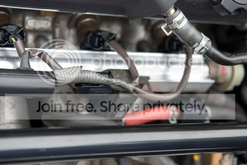

Ok, so where is the solenoid? lol I know where the canister and hoses are, but can't seem to find the solenoid?

Ok, I plugged the chipped ECU back with the jumper harness without unplugging the evap solenoid and the car started right up. Obviously affected when I fill up, I still need to locate the solenoid and try unplugging it next time I fill up.
Any ideas why this occurs?
After looking at two different diagrams and having no help from my Haynes manual, I think it may be bolted to the fuel rail:
Here is two different diagrams:
And here is mine:
What I think is canister (left) to evap solenoid (right)
Another shot of the proposed evap solenoid:
