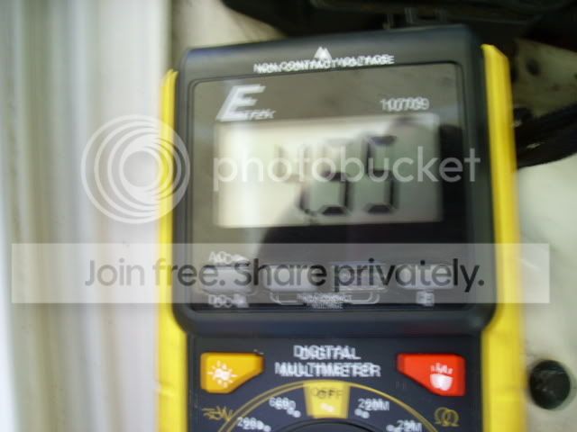

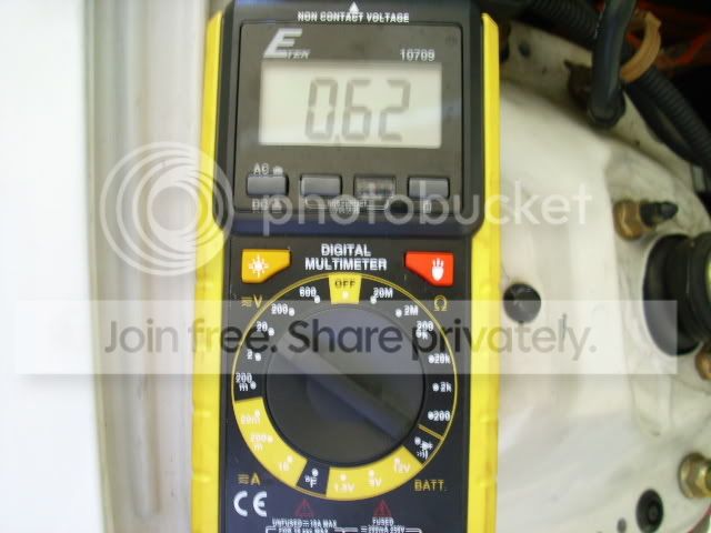

.62v Closed throttle
4.55v WOT
this is how the motor idles on normal operating temperature and the TPS is set to .62v closed and 4.55v WOT... I also tryed .5v closed still idles the same as the .62v closed....
BTW, i am using a 94 civic CX OEM TPS sensor on the Professinal product 68mm tb

when I set TPS's I only focus on being exactly 4.50v at WOT. Far as I can tell, the ECU is fine with lower than 0.5 closed because 3 of my cars were lower than that out of the factory.
If you're having a bog, I would guess there's an airflow problem. Make sure your idle screw is where it should be and that your fuel system can keep up with all the extra air a 68mm TB lets in.

If that's where you need to be for normal idle speed then you're fine. A Civic I tested OEM was at like 0.38v so .6 isn't that surprising.
I thought about this some more and a bog would be too much fuel, not air. A tune may be exactly what you need. How's your timing?
