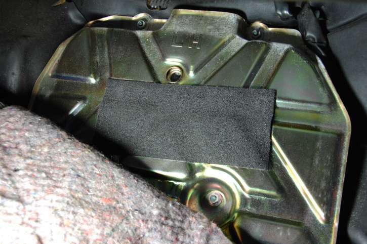

Does your ecu have a hole on the top cover of it?
http://www.jshmotors.com/images/prod...-Parts-002.JPG
Old Dec 5, 2015 | 08:47 AM
1990IntegraLS's Avatar
Joined: Mar 2015
Posts: 875
Likes: 10
Default Re: Timing short, check engine light
I've never pulled any carpet up, it's in pretty good shape.
The ecu is right under that plug?
...behind the plastic or under the rug?
It shows it in my original service manual, but the "drawing" is poor. I'll probably look for is Sunday.
I'm only the 2nd owner of this car and it came with a slightly beat up 1990 service manual, but no index other than sections. It's quite hard to find some things in its some 400 pages.
Old Dec 5, 2015 | 09:55 AM
F22Master's Avatar
Joined: Oct 2012
Posts: 1,858
From: Orlando, FL
Obd0 ECUs that have that hole on the cover have a single LED inside the ECU that flashes the code(s). The CEL does not flash the codes for these ECUs

I did'nt take off this plate because even though the carpet looks very good, it's quite brittle. I tore the corner by the door molding just a little, doing this. I'll take the plate off if necessary, but I'd rather not ruin the carpet if I don't have to.
I got up close to the sight glass with a flashlight and magnifier. All I can see is green circuit board with the led soldiered to it. It doesn't look, thru the sight glass, that there is any other cover than the big plate. There could be, but I see no brass or plated cover inside, just green pc board, the the led and other solder points.
I'll try plugging the vin# into a couple acura parts websites and see if I can find out more.
**updated. I plugged my vin into delray acura's parts finder and found what they are showing as the "control unit". It has a hole in it, similar, but a bit different than the one in your link.
All I can see in the sight glass in mine is circuit board, some solder points and the red led.
Maybe I have to take the plate off and risk tearing the carpet, but I"m going to try one other things first. Study the adjustment better and see how much difference there is with and without the paper clip. I'm willing to take the time to do that.
