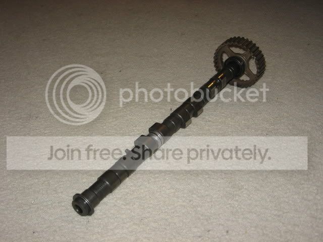

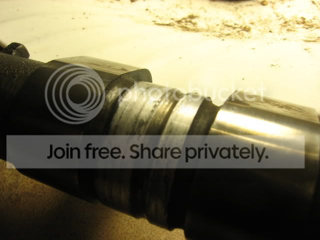

Hey guys.
My oil light was on since I bought the car about 2 weeks ago. I did an oil change on it early this week but the oil light would still come on in the cold mornings for about 2-3 minutes then I would see it all day long. So last night I changed the oil pressure switch but no luck, same thing happens this morning, oh well I think, it's been doing since day 1! So I get on the highway as usual and 5 minutes later, bahhhhhhhhhh, engine dies. I get the car towed to the shop I work at and start looking at what happened. Engine cranks but no fire, start looking at the ignition distributor and its all good. I start to turn the crank with my ratchet to align the pistons and stuff to do a leakdown test but man it's easy! Decide to pull the valve cover to look at what I fear the most... Blown timing belt! So I decide to pull the head, first thing I remove is the exhaust cam and then bam, here is what I got(pics at the bottom). So I guess my oil pump decided to pack it in and a cam support got dry. It half seized and ripped the timing belt in two. So I stoped there, decided to look for a head. Good thing a guy in my own city just puted one for sale at the same time. So I went and bought it. So tomorrow, i'll pull the head out, look at the pistons, remove the pan and look for rod bearings that could be damaged etc. Hopefully everything will be fine and then slap the new head on and keep on going with the project!

You should have checked for oil pressure.....thus the reason for an oil pressure light

dude your just going to slap a head on it and call it a day. yea it must have just been the oil orfice for that cam cap was plugged its probably not the oil pump or anything like that.

Problem solved, I just swapped out the complete engine. I kept the old one and will be rebuilding it slowly as strong as possible.
