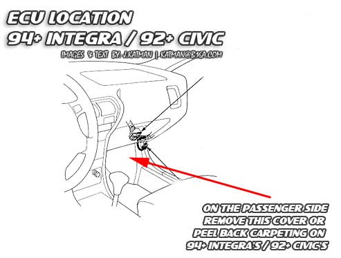

Pictures?

Default Re: ODB2 Code Reading Question? (ORcivicsi)
<TABLE WIDTH="90%" CELLSPACING=0 CELLPADDING=0 ALIGN=CENTER><TR><TD>Quote, originally posted by ORcivicsi &raquo;</TD></TR><TR><TD CLASS="quote">Pictures?</TD></TR></TABLE>
only pic I have online is this one:
