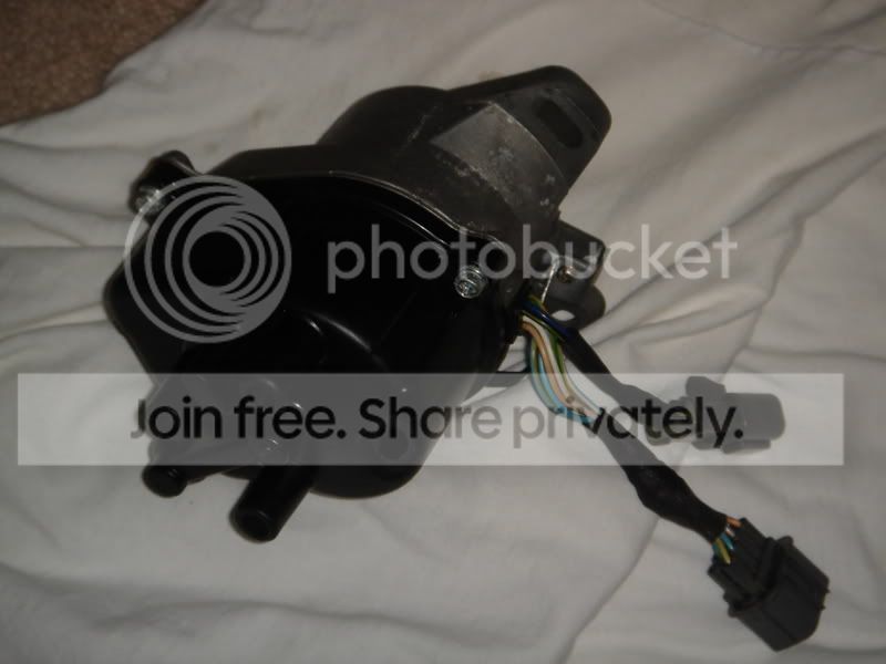

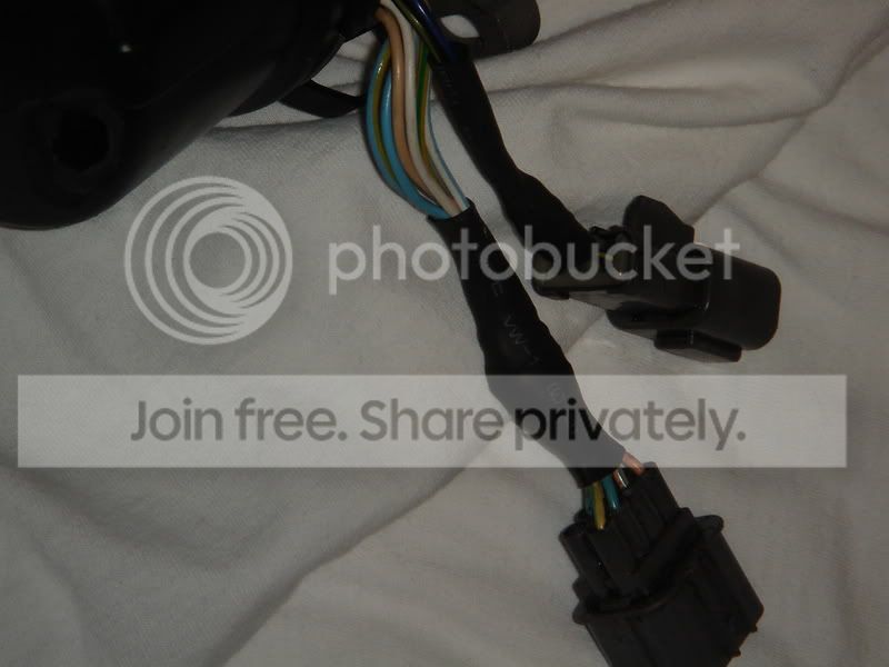

so i got really bored and started taking random pictures and thought id shared pics of my distributor..i need a life
lol
oem quality
lol
oem quality
