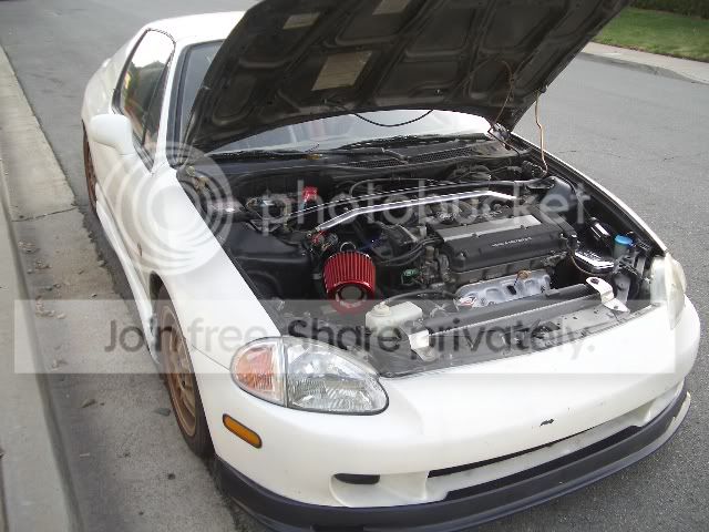

he car is driving but i haven't hooked up the IAB, second o2 sensor or ICAV.
the knock has been wired.
i was told i didn't have to wire vtec because "all 93 delsol's came wired for already... is this true??
also where do the 4 wires from the second o2 sensor go?
any help is great (my brother is doing the wiring but i need to provide him with some info)
