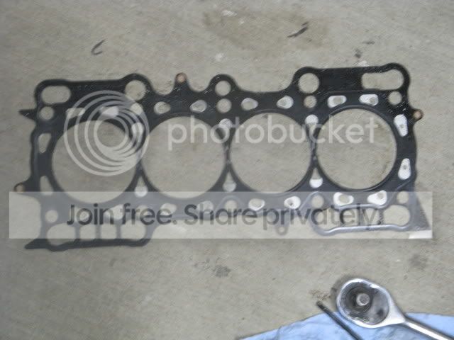

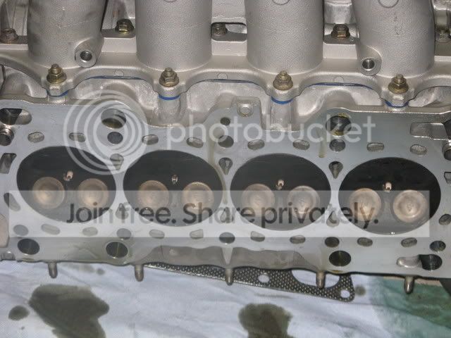

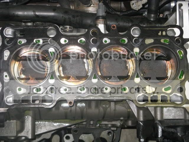

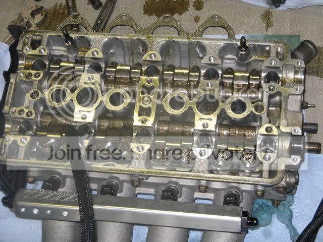

well took off the head, to see if for some crazy reason. maybe the HG ws on worng. Everything looks fine.
Maybe you guys can see something we arn't.
I gotta ask. Should the "pointy tabs" on the left point @ the t-belt?

you are missing an o-ring in the center of the head where the cam cap goes.

Once again, what is th proper way the HG should go???

Check the "o" ring, and I have seen H22's with a dented oil pan not get VTEC if the pick-up is to close to pan floor. Also put a mechanical OP guage after the VTEC solenoid on the head, if it drops below 60 lbs. VTEC will stop functioning. Make sure all the rocker pins are in.
