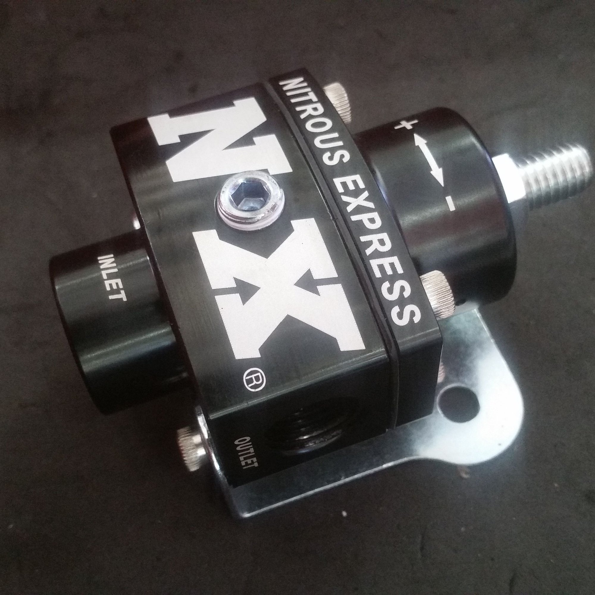

Soo has anyone ran a non bypass fuel pressure regulator? I have this regulator but I'm not sureally if it will work on a honda setup
