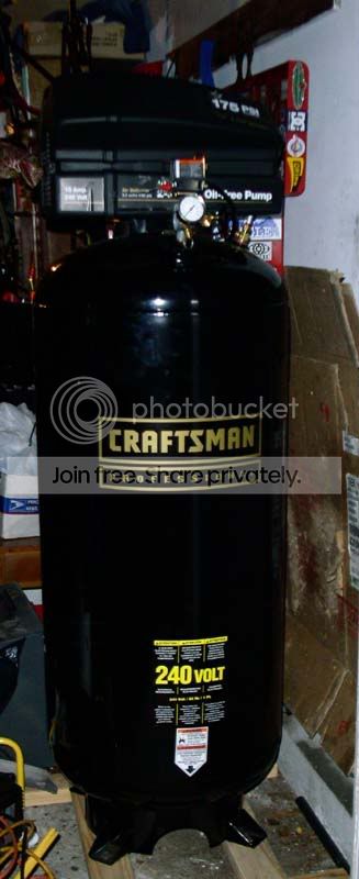

if you like that, your gonna love what is powering it
60 gallon, 175psi , 240 volt compressor
