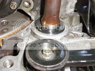

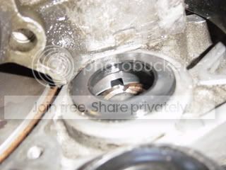

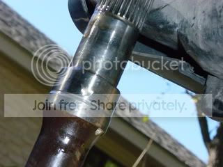

my transmission is leaking from the driver side axle seal. i noticed that there is a lip where the seal rides on the intermediate shaft and i have been trying to align the seal with the lip. i have repositioned the seal at least 3 different times now and have replaced the seal once.
if that sounded too confusing heres some pictures:
here is the lip that im talking about on the intermediate shaft
the inside diameter of the seal has a V shaped lip that i think runs on the axle's lip
heres how it looks with the shaft inside the transmission

All I can say is that when I did the seals on my Y21 I put them in as deep as they could go and they don't leak a drop.
From what vehicle/year is your intermediate shaft from?

looks like an aftermarket seal, and they could have given you the 90-93 teg seal which is 5mm bigger ID and will leak like you describe

The seal should be set deeper. Flush with the case is about right.

i already tried installing it flush
i'll pull it tomorrow and compare it to other sizes
though the last time i had it out i put it on the intermediate shaft and seemed pretty snug

yeah i tried a couple of different sizes and grab the one that was the most snug
i installed it in just a little bit more than flush and now it is not leaking at all
thanks fellazzz

get a seal from HONDA, not that POS.
Honda seal, outer edge flush with the case
