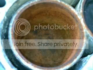

Block left outside and 1 and 4 cylinder has a nice amount of rust on the cylinder walls. Whats the best way to remove the rust just enough to get the pistons out and the block to the machine shop? It was left out for a month,so you can draw your own picture.

Never actually done this, so you may want to get a different opinion before you try it, but it would seem like you could just sand the rust off if you were going to get the block machined anyway.

i honeslty don't that can be salvaged. maybe if you go .5 over

It can Make Pitted holes, that can go all the way through the cylinder, which in that case no matter how much you bored it, it would still be there, but maybe its just a service rust..
To get the pistons out i would probably spray the **** out of it with a rust penetrant ( somthing good like pb blaster)
Then let it sit and try pounding them out with a dead blow or somthing... then maybe get one of the drill powered cylinder hones from the auto parts store,

i would just spray it with some wd40 and let it soak in then knock the pistons out after that i would sagest going 20 over

Thats exactly what I was thinking, what stock honda pistons would drop in there after .20 0ver?

you can just order the pistons for your block in 20 over or if its a b sires block you can step up to itr or ctr pistons in 20 over
