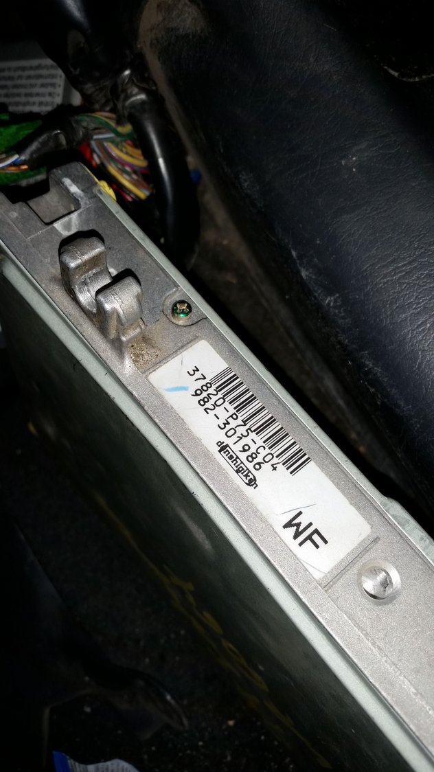

Hey! I have a p75 ECU and the one grey connector from my wiring harness in the engine swap I'm doing will not plug into the ECU. Any ideas?
Car is
a 2000 Acura EL with a 1998 acura integra b1b1 motor and ECU

96-98 =obd2a
99-00 = obd2b
OBD2a have different "connections" from obd2b.
Thus you need a conversion harness from obd2b > obd2a.
OBD2b to OBD2a ECU Conversion Harness
