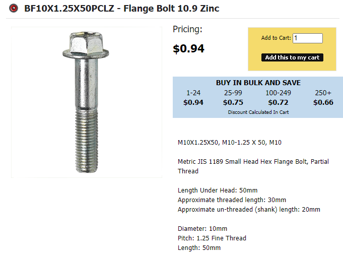

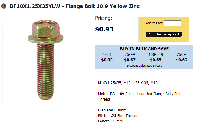

When things aren't available, try to figure out what it is from the parts fiche, then look for something similar here: https://www.belmetric.com/
Most of the stuff on these cars is JIS small wrench.
Here's your 35mm:
and the 50mm is likely partial thread:
