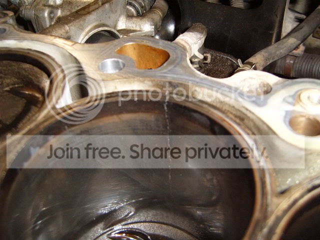

im just curious, what is it about the no 3 cyl that makes it weaker than the others? im just curious cuz my #3 sleeve popped on my ls-t, and i have seen a million others that have done the same thing.

It runs hotter than the others because it has two combustion events occuring on either side.
The ignition sequence is:
1-3-4-2
So when you view the cylinders:
1-2-3-4
You can see why #3 runs hot. After it fires, #4 fires directly to it's right, then #2 fires directly to the left. This keeps the cylinder hot which means it's more prone to detonation on the next cycle which means it's more succeptible to a cracked sleeve.
The #2 cylinder runs the second hottest. After it fires, #1 fires directly to it's left, then #3 fires directly to the right.

Yep. Extra heat causes detonation. Detonation blows sleeves.

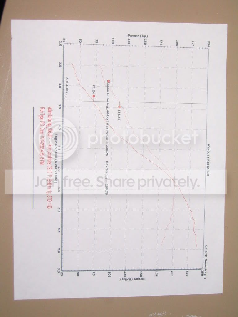

but my car never once detonated. i kno that ls stock internals are good to about 250 hp and the sleeves are good to about 300, and i was making 238 hp and 200 tq at the wheels so i should have been well within the "margin" as far as the sleeves go.

Right, well with a good tune, the sleeves will hold 400hp. But they won't hold 238 when you're detonating.
