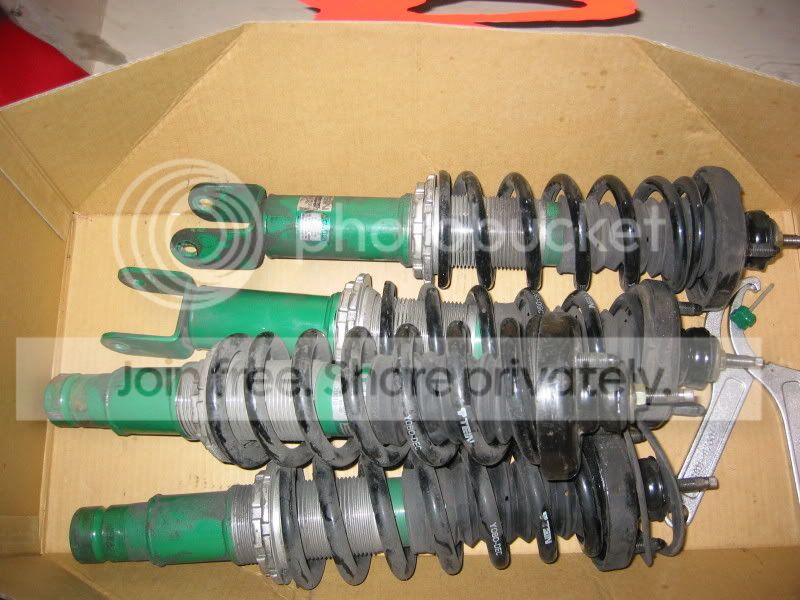

Since there seem to be a few people that dont understand coilover...I'll try my best to explain what i've learn over the years..
These are my tein SS coil overs...They are damper adjustable and height adjustable..No preload adjustment...

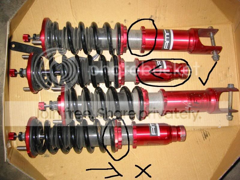

These are my AMR coil over system. From my understanding they are using FF2 shock body and using their own spring rate. These are damper, height and preload adjustable. I made a couple of marks to this pictures so this might help.
On the picture i'll be explain it from top to bottom. As you see i circuit at the top, the "preload' adjustment. If you have a preload adjustment it's best to lower your car with that so the shock can have as much travel as it can. When you adjust the preload as you see, it moves the should body upwards instead of moving the spring downward. Try not to adjust the height from the spring perch as i circled it on the last shock.
