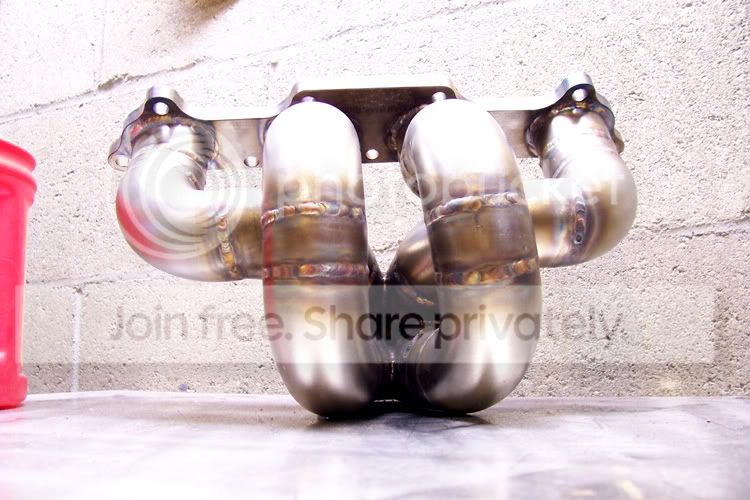

I generally never post my stuff, but I finally had someone want a mani out of 316. Not much different overall to be honest. I backpurged the entire mani, but I admit I still have to work on that 100+% penetration consistency (I have another thread about it).

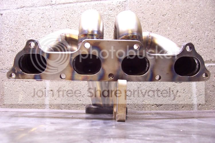

Person getting this mani is running a GT28 with that T25 flange and I guess the person had trouble finding someone to make one. The collector fit to the T25 is a little tough so I assume that's why. It seems the bolt holes for the flange are tight to the collector and collector to that small hole required some jig workage.
I figured I'd give it a shot for the guy though....I think it came out ok. The T25 flange is from the guy I made it for. He made it on a plasma table and wanted me to use it.
I'm not as good as some of you guys on here, but I do what I can...shakin from the athsma meds and all .

looks good! how do you have your back purge station setup? IF you home some pic if you don't mind sharing?

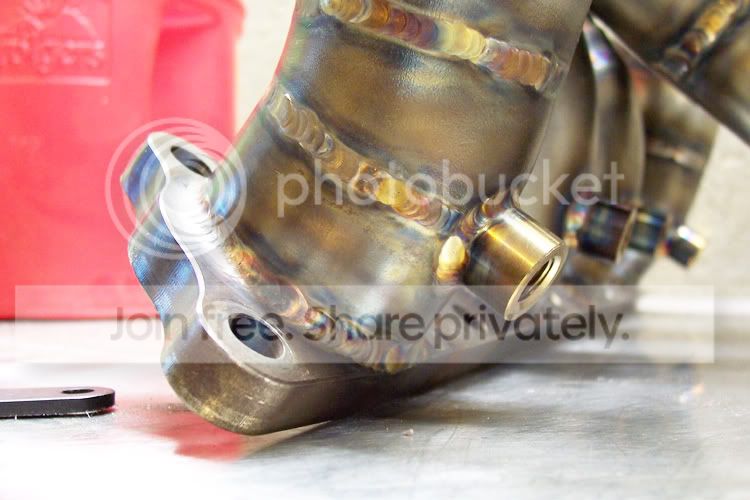

Whats the tool being used for the 4 egt ports? 4 channel dedicated datalogger? or an ems with enough inputs to handle it?

looks effin' great man! i mean really. thats top notch!

Hey, thanks for the comments guys....I appreciate it.
Splitime....Best I recall is he knows someone closely connected to the development of ECtune, so I'd assume that's the management system he's using. He said he wanted to didn't want to hold back on this project and really do everything as good as possible. I actually am shipping the mani off to HP Coating today, and it is getting their black thermal barrier coating.
RTernie.....I don't know about TOP notch...lol. What I lack in welding I try to make up for with porting and making everything flow as well as possible. With the welds I have to stop and start alot, which is a downfall. My meds give me alot of, unnoticeable in life, but very noticeable when your TIG welding shakes. I have to actually hold my breath when I weld to suppress some of the shaking like I'm some Vietnam sniper...lol. I end up having to make about 6-8 stops on each joint.
Last year I was on different meds and it was alot better. I could do a whole joint in 4 stops, but not anymore. I try to do the best that I can though and make quality stuff....some people just get wrapped up in the perfect bead look (thanks full race), which I'll probably never be able to pump out unless I am healed miraculously.
Thanks though for the comment, I appreciate it alot.

Fun, that hints at individual cylinder trims. I wonder if they figured a way to datalog all four through the ecu too.

The individual runner sampeling is most likely for EGT and if you have a single channel, you could always block off the other ports and datalog one port at a time.

that looks real good man, alot of stops doesnt matter as long as you tie the start and stops in well. looks damn good

Yeah, I mean, if I re-arc on the end of the bead where I stopped it looks like a continued run....the HAZ just gives the restart away.

o great work btw! love the 4 cylinder EGT

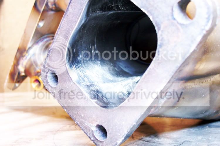

love the polishing on the inside of the collector, where it actually counts! what are you on for the asthma? my wife works for pharma co. and sells asthma related products.

Yeah, I generally don't all out polish them in case anyone is wondering. Due to the fact that generally there is going to be a carbon layer developed in a short time, and the fact that there is a pretty static boundary layer anyway I just leave a 120grit finish then scotchbrite it really quick. It actually is quite smooth to the touch versus how it appears.

anywayyy I love the way the inside of the collector looks like it is a molded piece.....can barely see the seems between the peices great work

Fully welded on the inside....so no seams.... Might be the lighting if your seeing something that looks like one. My camera pics up the collector funny for some reason...it looks HIGHLY textured, but in person it's not even slightly textured looking. The camera somehow picked up the reflective light funny or something.
I think the only visible variation is the color of the mild steel versus the stainless. The mild steel has a darker shade to it.
