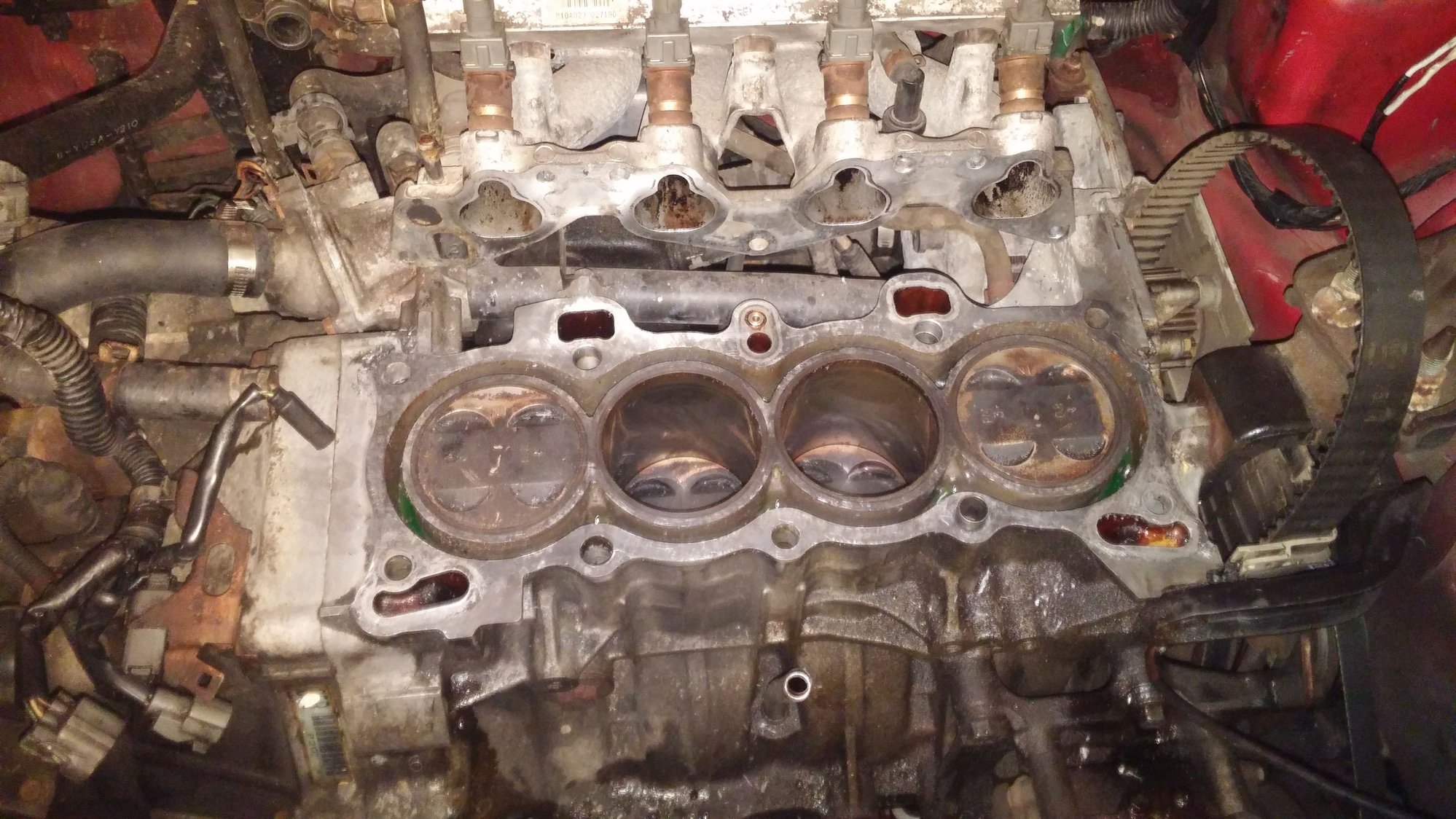

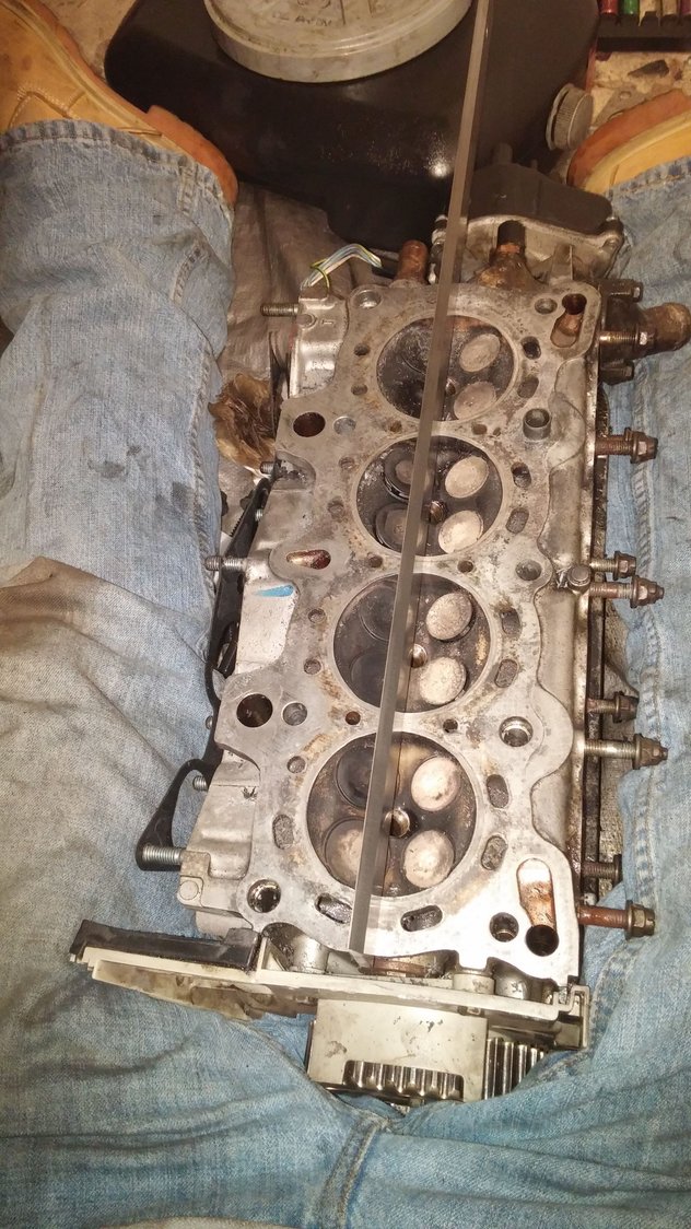

Getting started on the engine maintenance. I'm gonna try to keep this short, since maintenance is not considered "building" a car.
Brake parts and engine parts:
After pulling the cylinder head:

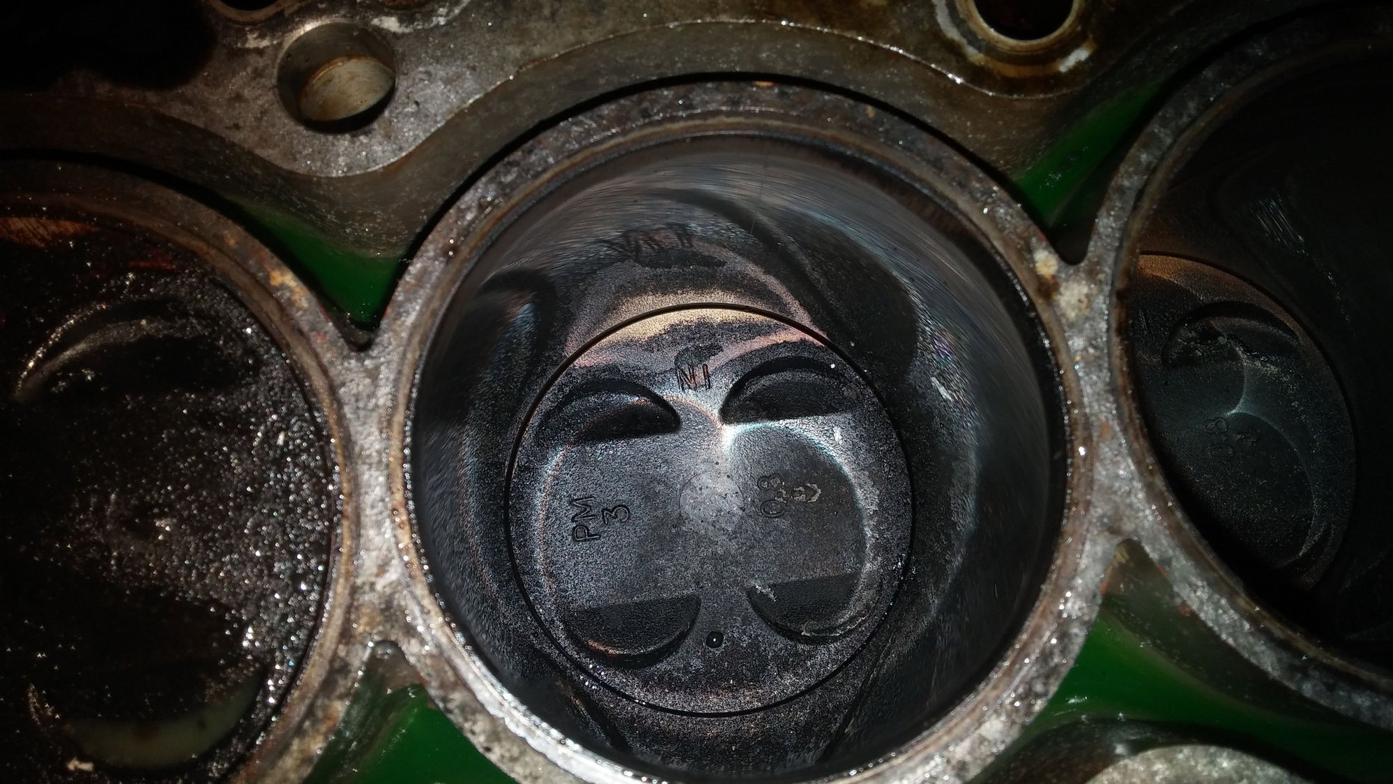

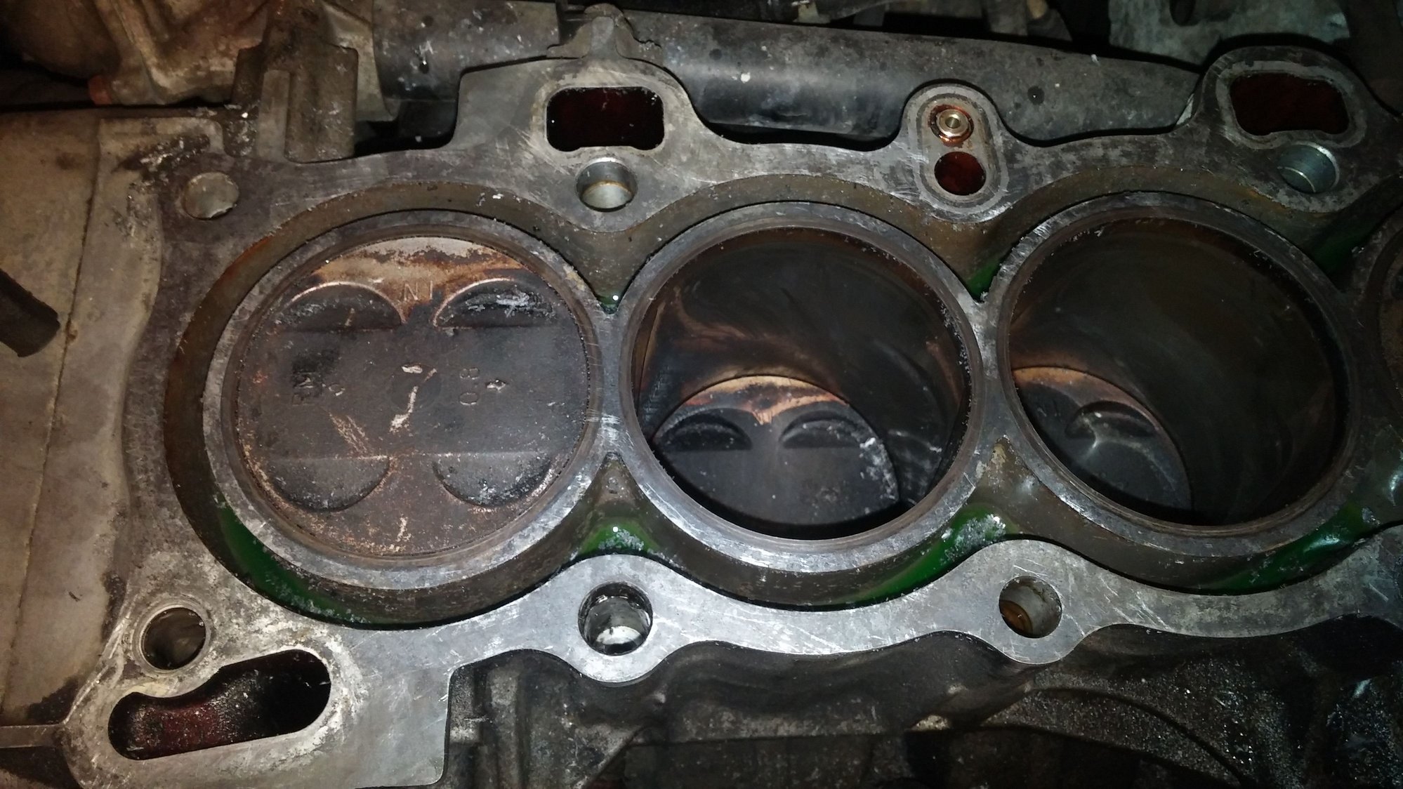

Here's the condition of the pistons. Aside from carbon buildup-- there is no evidence of coolant leaking into the combustion chamber. In addition, I could not see any trace or smell any trace of hydrocarbons in the coolant jacket around the pistons.
I'm very happy about this.
Then I cleaned up the deck with a razor blade and some brakleen:
Measured warpage in only one direction, since I didn't have the space in the engine bay-- it was less than 0.003 inches:
Then I cleaned up the cylinder head and measured warpage. It was less than 0.002 inches:
More to come today. Friend is coming over and will help me with the water pump and timing belt and also the brake bleeding and hawk pads.

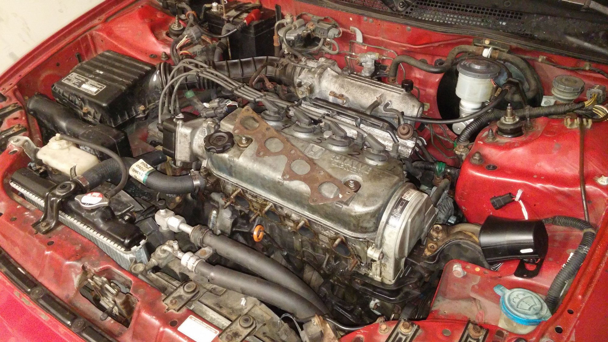

Okay. So, the motor is back together and the car is ready to get inspected for my first PDX with the South Jersey SCCA.
After copper-coating the gasket and putting the head back on the block, I torqued it down and got to business:
The timing belt needed to be put on, the timing cover needed to be reordered and installed because the old one was destroyed from removing the crank pulley, the oil pan needed to be re-sealed with HondaBond because it was leaking, the water pump needed replacing (along with all of the pulleys), the spark plugs needed replacing, I needed to replace my valve cover gasket, and then I needed to reinstall the pulley and the accessory belts.
While removing my header, I also destroyed the stud TWICE that bolted it to the downpipe, so I had to drill that out and retap it...and in the process I broke my drill.
I love it when people say stuff like, "oh yeah, it's so easy" to do stuff like this to cars.
Here are some pics from the work:
When I started the car, she was much more responsive. Revs were happy and quick and the oil and coolant didn't show mixing at all. Belts were a little tight, but I may leave them that way since I can't see them breaking in the short run.
Maybe after inspection I'll fix them.

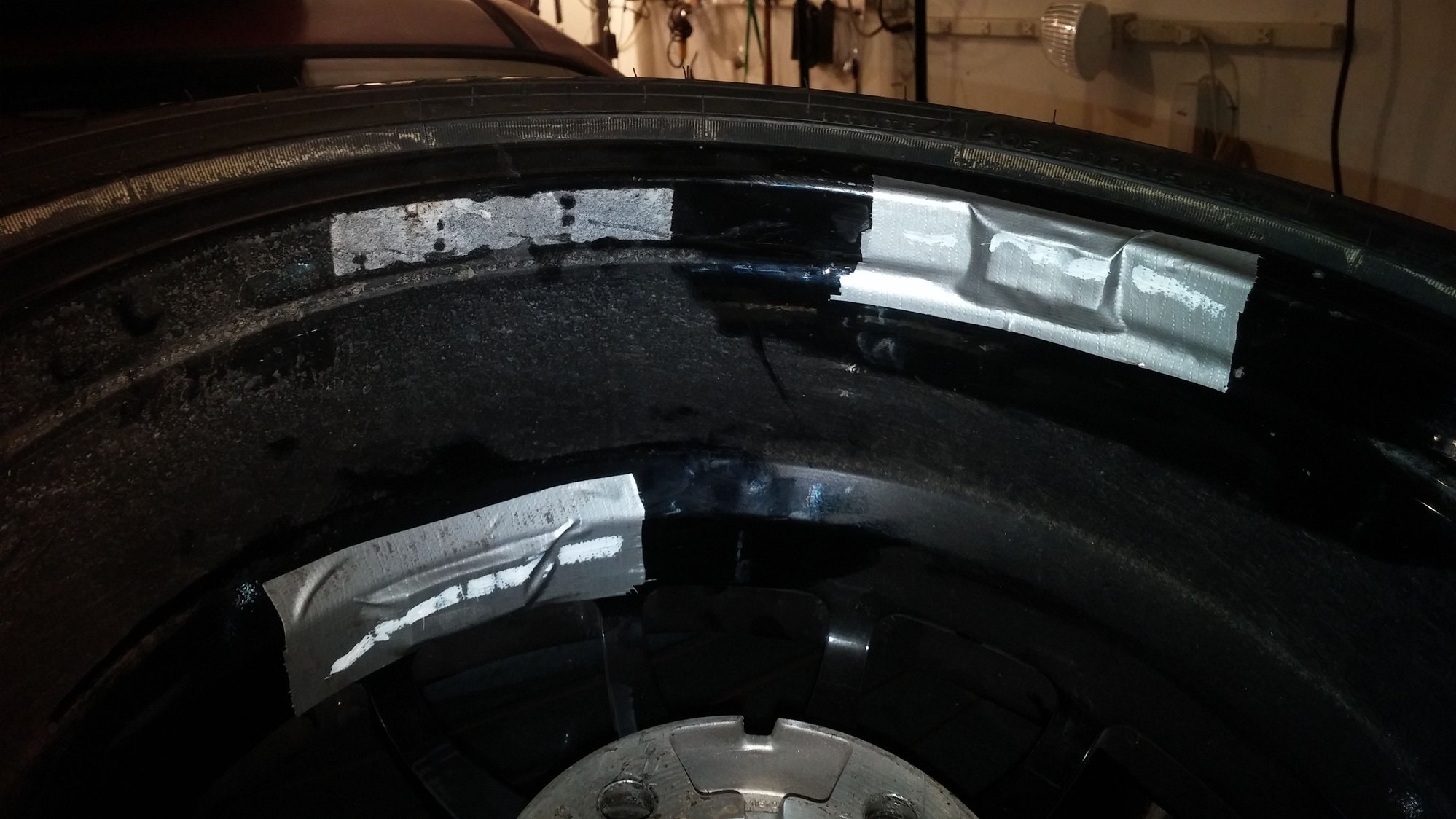

If you all recall, before, I was using a bunch of random crap to simulate my weight in the driver seat while adjusting ride height. Well, today, I got 200 pounds of gravel and put it in the driver seat and got to business!
Then I taped the wheel weights to the wheels to be sure I wouldn't lose any at high speed (some advice I got from a friend who used to race S2 Prototypes with the SCCA and Formula Atlantic):

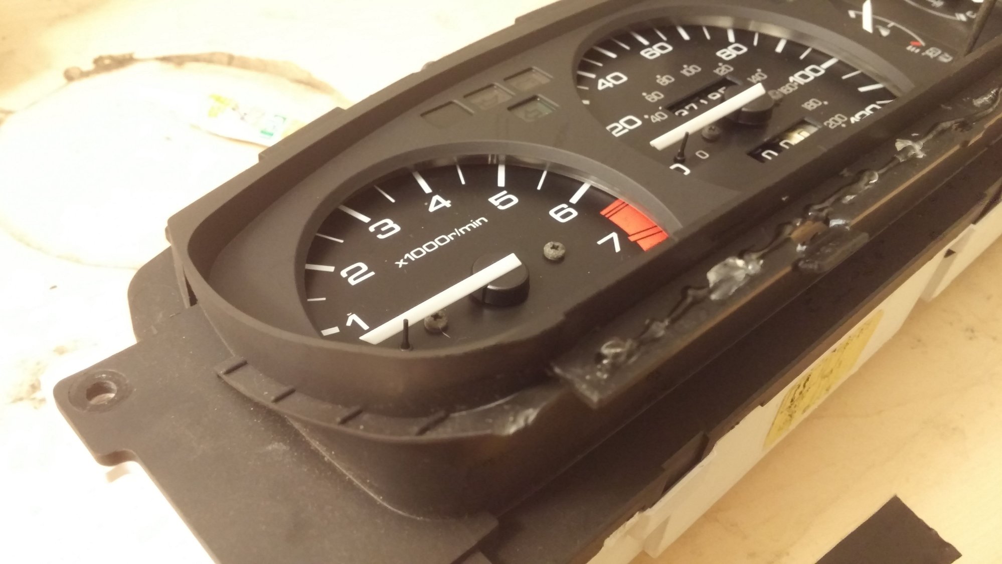

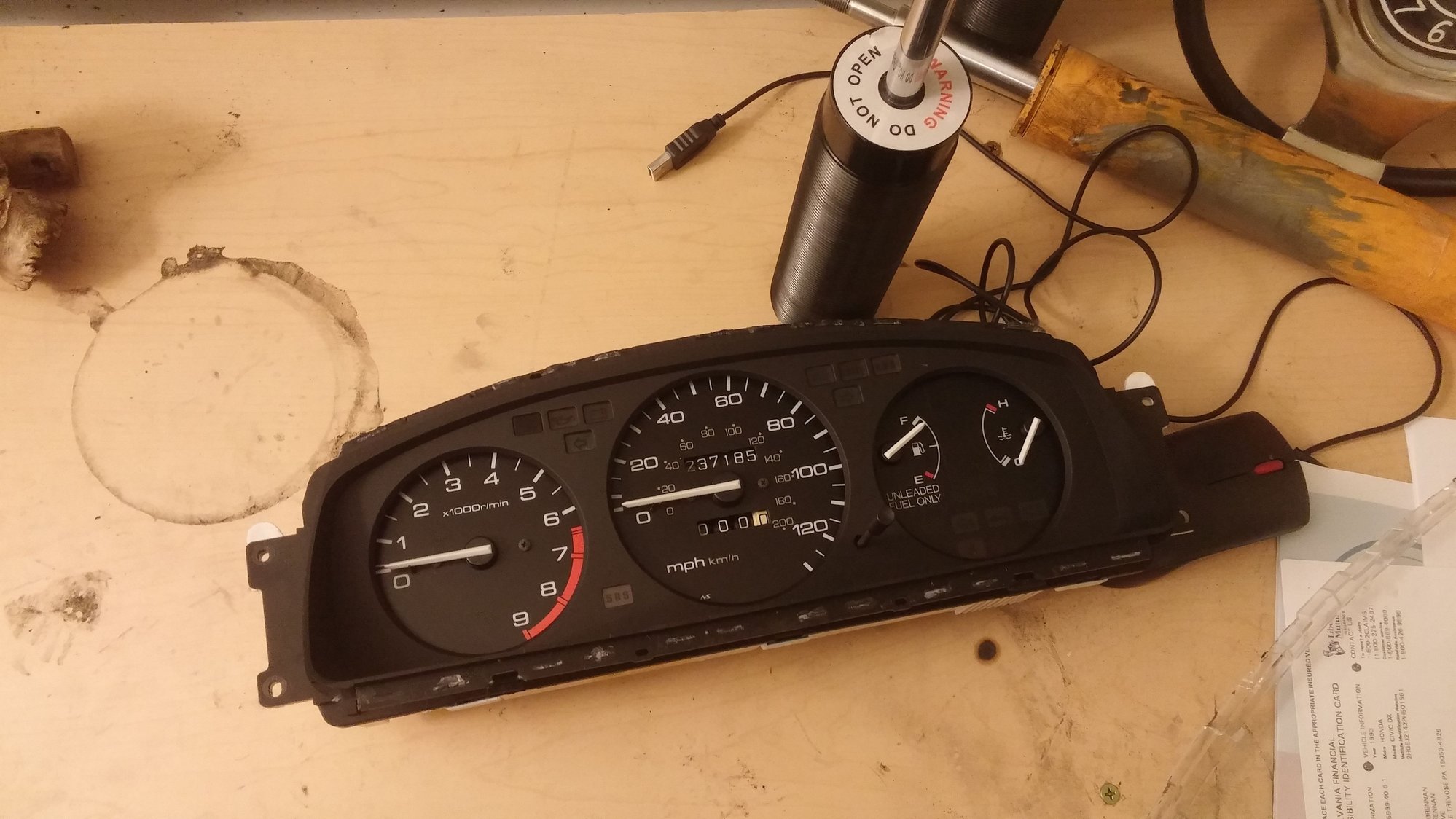

And finally, I took care of some cosmetic stuff-- like adding that little piece of tape at the center of the wheel because racek0r:

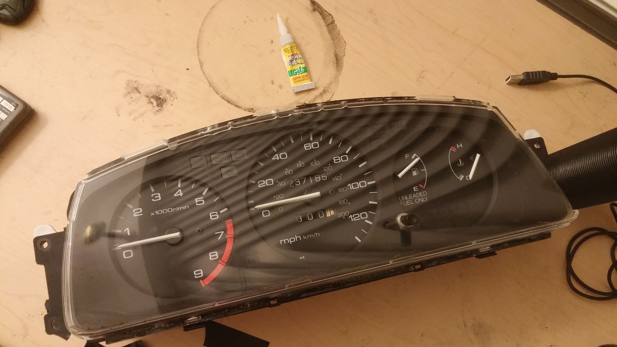

And I also taped the PRNDL on my EX Gauge Cluster to make it look more sleek! Here are some progression photos:
