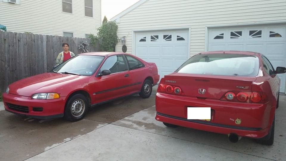

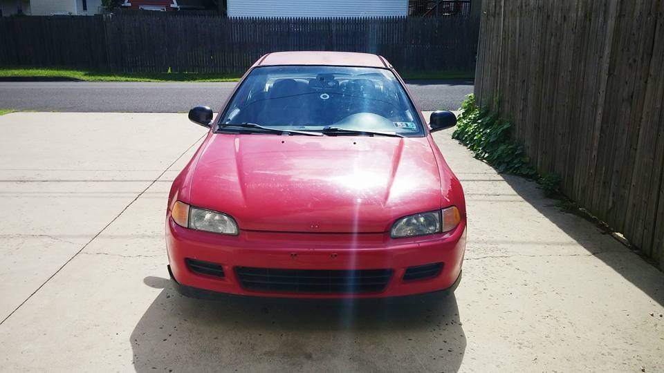

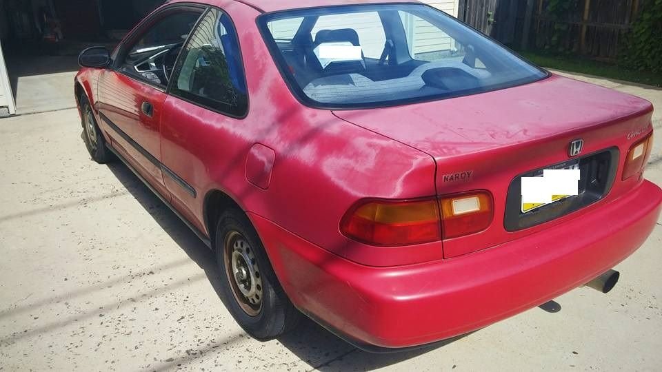

After months of searching, I found this EJ2 coupe with the only mods being a painted bash bezel, a Skunk2 Exhaust, and a radio. I didn't see any quarter panel rust or subframe rust up front, and when I took it for a test drive the car pulled well and ran very nicely. The bushings were all shot, but these would be removed anyway in favor of some hard rubber bushings from PIC Performance in the end.
I ended up paying $1,000 before taxes and tags for the car. The owner was a very nice guy who wasn't trying to squeeze blood out of a rock like most owners of good-condition, older Hondas do.
The owner did mention replacing a head gasket on the engine, and I do suspect that he didn't measure for warpage before replacing the head gasket. I do smell fuel in the coolant, but I have autocrossed this car twice so far and I have dailied it for a long time while I was fixing my RSX and I never had any overheating issues...
Needless to say, I will be addressing this problem in the future.

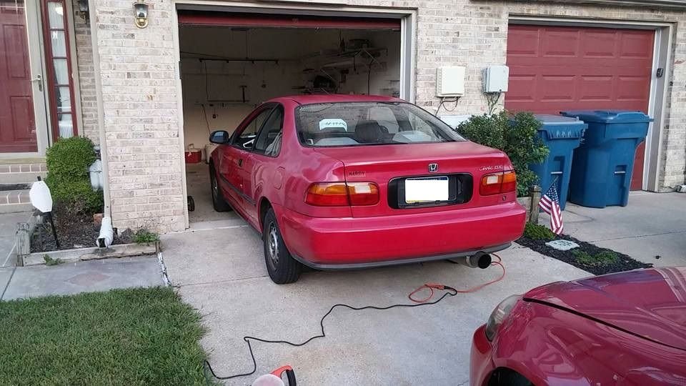

Parking her in my new crib:

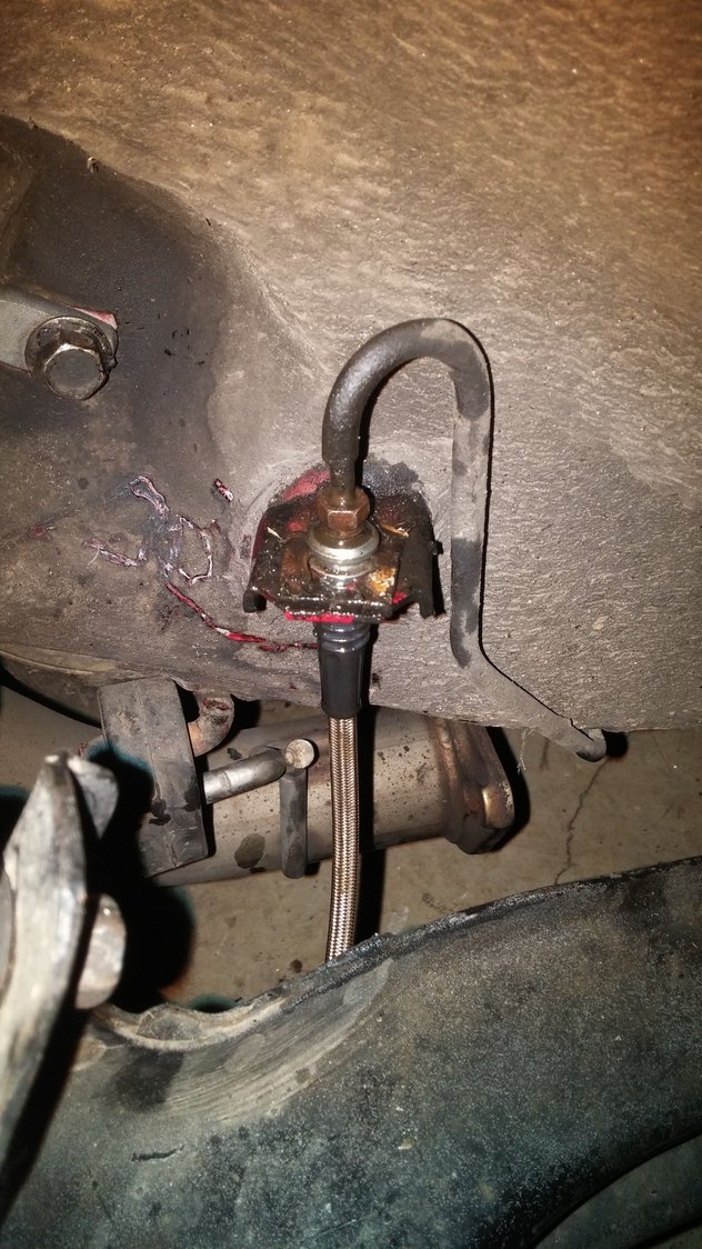

*Coilovers
*Bushings
*Integra brakes, front AND rear

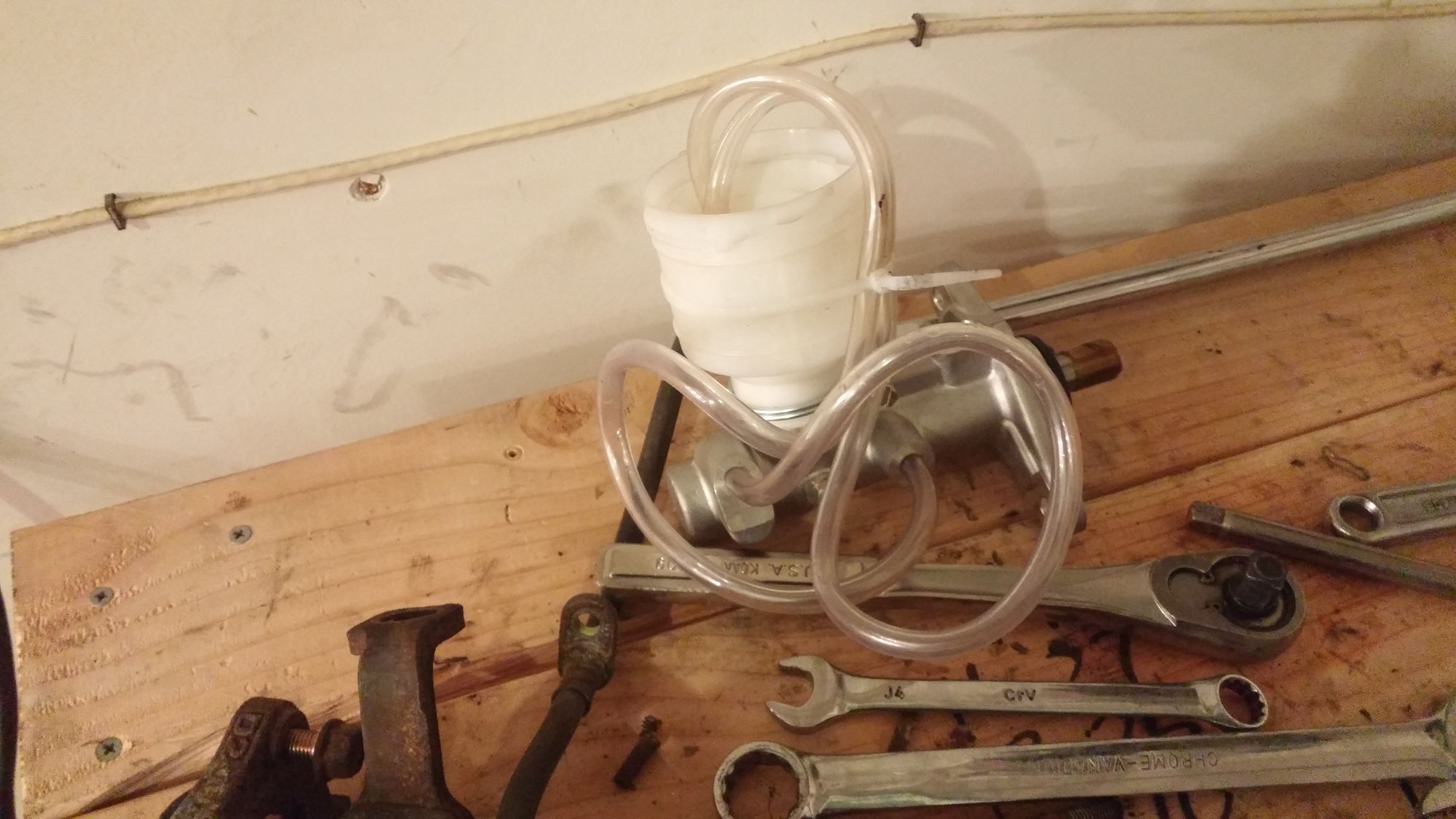

*91 Civic EX 15/16 Master Cylinder
*StopTech Stainless Brake Lines

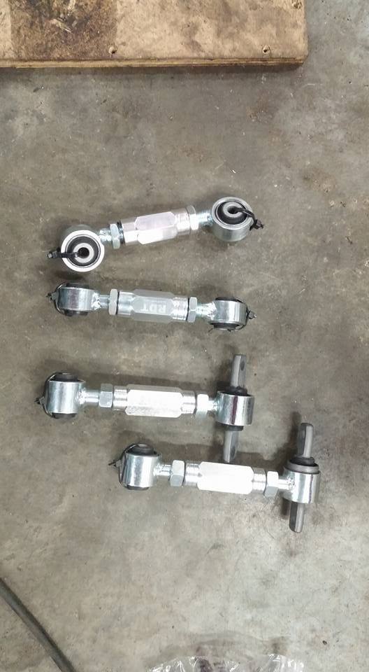

*Adjustable upper camber arms in the front
*Adjustable rear camber and toe

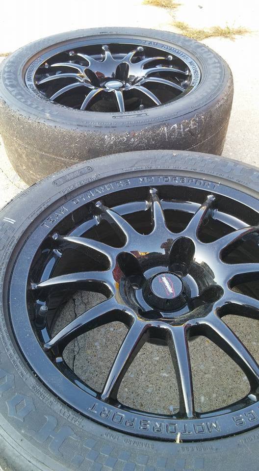

*15" wheels
*Sticky tires in 205 or 225 mm width (currently I have some 225 mm slicks, but if I want to run STS, I will most likely be getting RE-71R's)

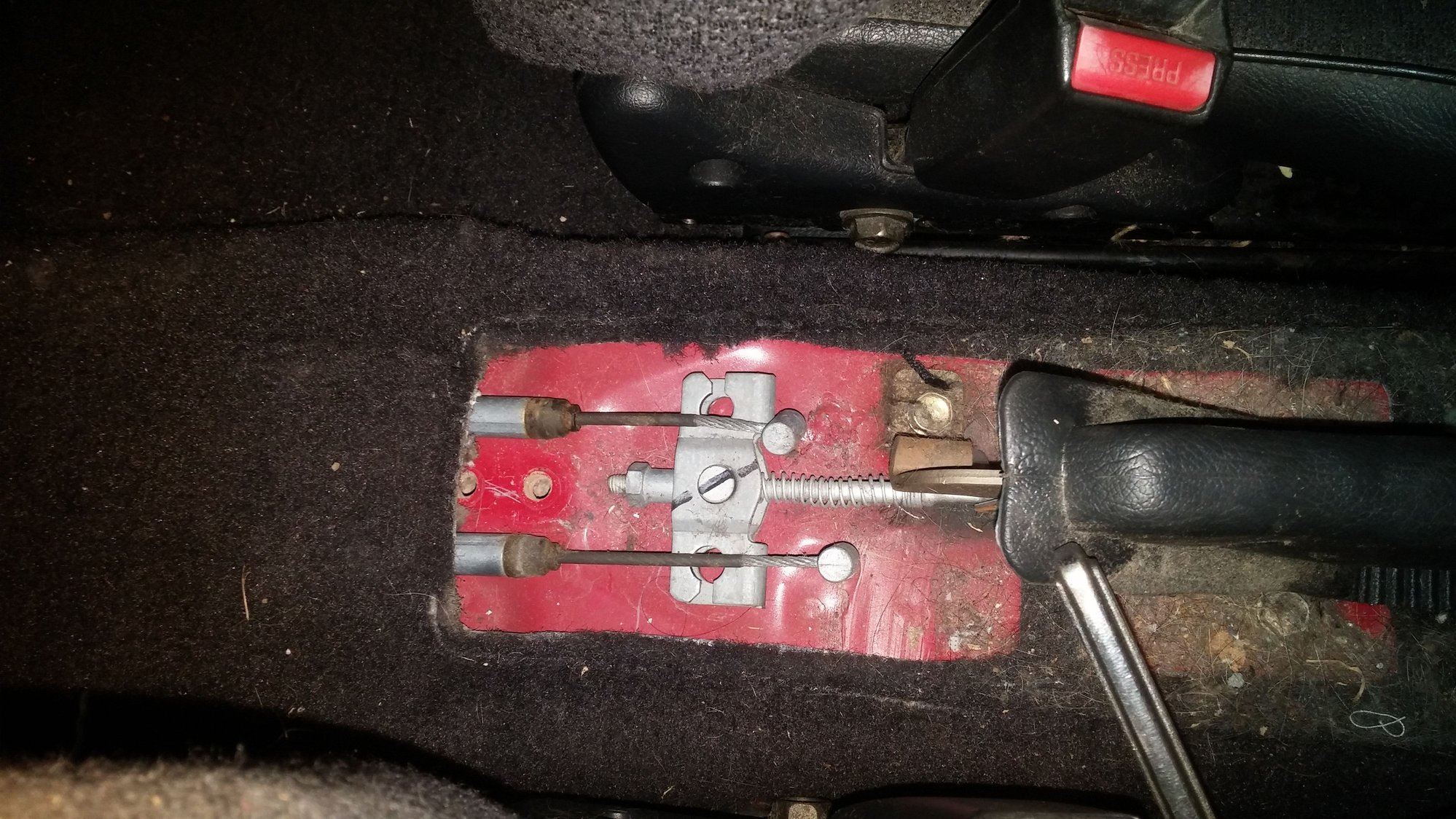

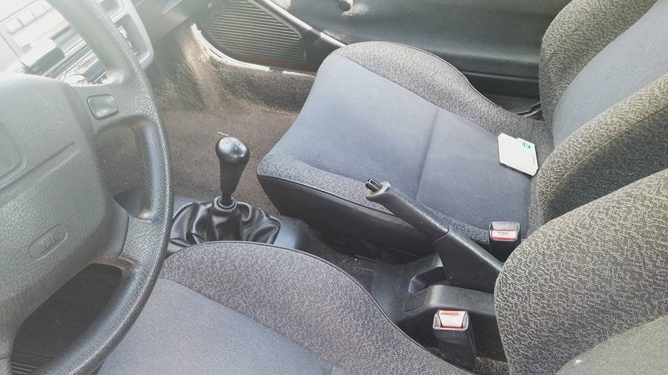

As soon as I bought the car, I obviously washed it and inspected it from head to toe. I changed the coolant, changed the oil, bled the brakes, ordered new brake pads for the front, ordered new shoes for the rear, and ordered new rotors for the front as well.
Boy, this car is fun. It's light and you can feel it. There's something about a lightweight car from the 90's that just gets me going. It reminds me of a Miata with FWD and I like that. I daily drove it to and from work to get a feel for it for a while, and you really have to learn how to carry momentum while driving it because of its lack of power...but I like that too.
After getting the car driveable and playing around with it a little bit on the road, I decided to get to work with acquiring parts. I replaced my white-painted dash bezel with a new OEM one and I also replaced the OEM clock with a working one, just because I wanted the car to be mint:

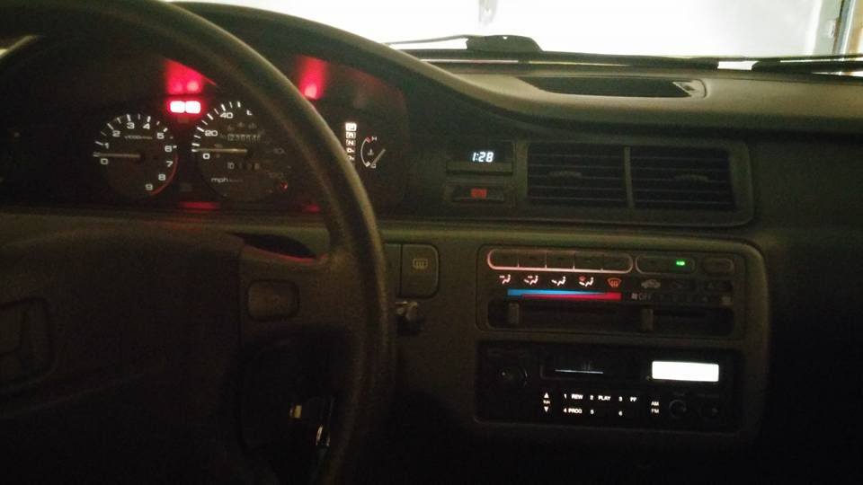

As you can see, I also put the OEM Honda radio back in for the hell of it, but soon after swapped it back out in favor of one with a CD drive...I will be working on fixing the antenna soon so that I can also get radio in the car while driving it on the weekends:

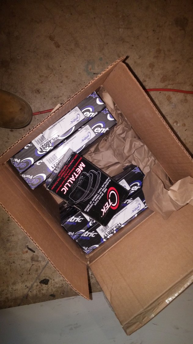

After buying some OEM stuff, I decided to start hoarding parts for the build itself. A friend of mine who races a GSR in Honda Challenge told me that one of the best brake setups I could buy would be a full, OEM Integra GSR brake setup (which is the same as any other Integra, aside from the Type-R). He then told me to throw some DTC60 pads up front and some cheap AutoZone pads in the rear. So, I began looking for Integra brakes!

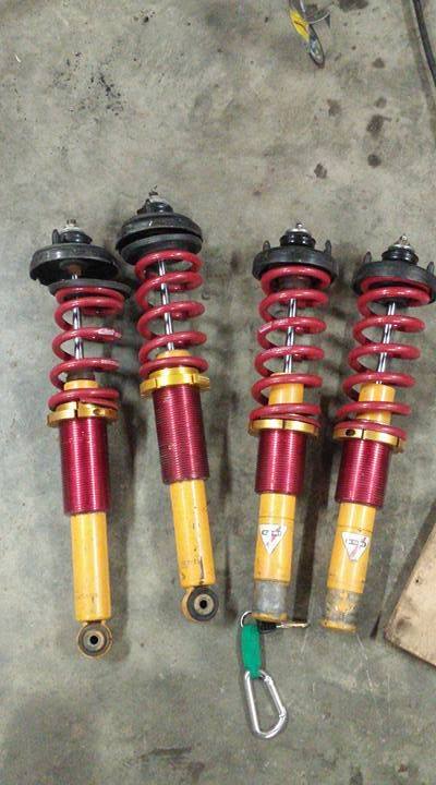

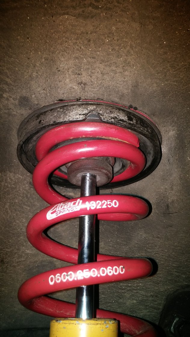

Next, I started researching what spring rates I would need to run in order to not have too much body roll while on slicks (since I was originally going to slowly build this into a Honda Challenge H2 car). The thread where I was asking these questions is actually on this site, and you can see it here:
https://honda-tech.com/road-racing-a...etups-3259584/
Basically, some of the great members here on this site referred me to a sweet deal on some Koni/GC coilovers that were revalved to SPSS3 specs for stiffer valving. These Konis also came with the Eibach Race Springs in 500#/f 600#/r configuration. The price was great, and so was the condition of these coilovers, so needless to say, I pulled the trigger:

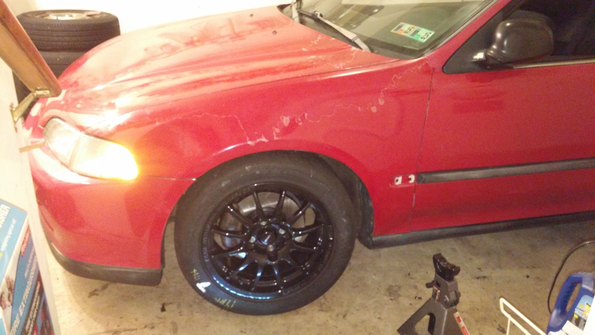

And with my first autocross event with the Civic coming up on THAT weekend, I quickly found some conical lug nuts (open-ended) at Pep-Boys, and bought them so that I could mount these slicks and get to driving!
When I got to the event and got the car tech'd, everyone was laughing because my Civic was at stock ride-height, on stock suspension, with some really wide slicks. I didn't care. I was there to shake the car down and have a blast in my new Civic! In grid, I was revving my engine and telling everyone to "dig race me bro" because I am a troll.
Then I ran the car. After my first heat, I had a smile from ear-to-ear. I was laughing my a** off with joy because it was so much fun to get all of the oversteer due to the toe-steer in the rear of these cars and man-handle the heavy, manual steering that I wasn't accustomed to with the RSX. I got a lot of attention because of all of the body roll, and our local photographer even posted this photo to his page (we normally have to pay for his photos), asking "got body roll?" So much fun!

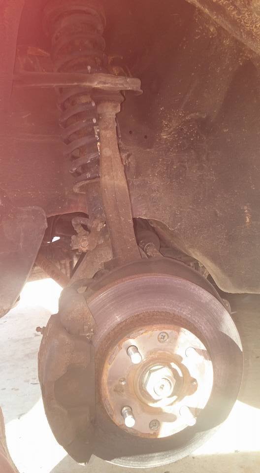

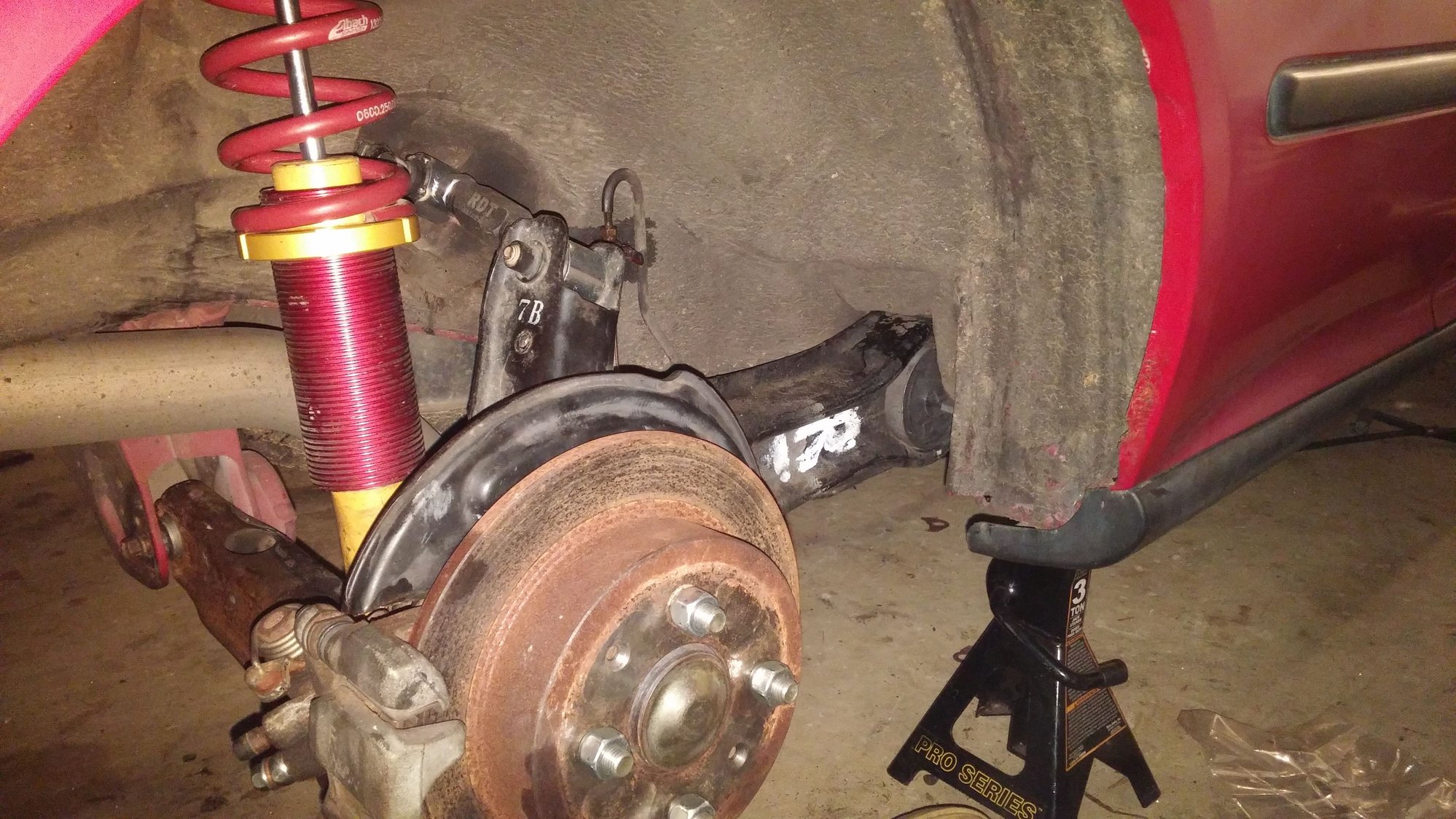

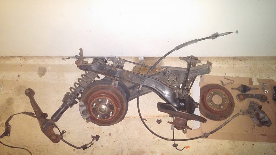

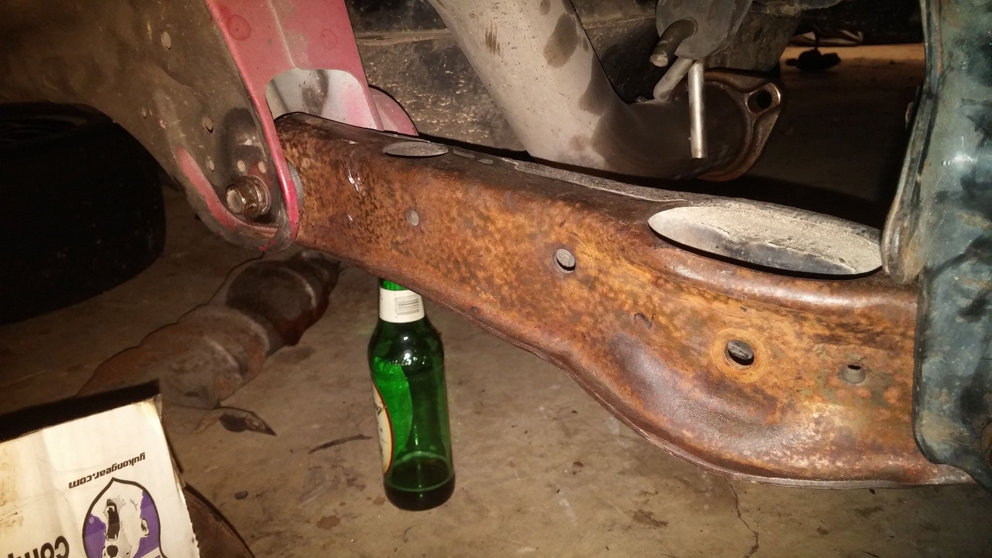

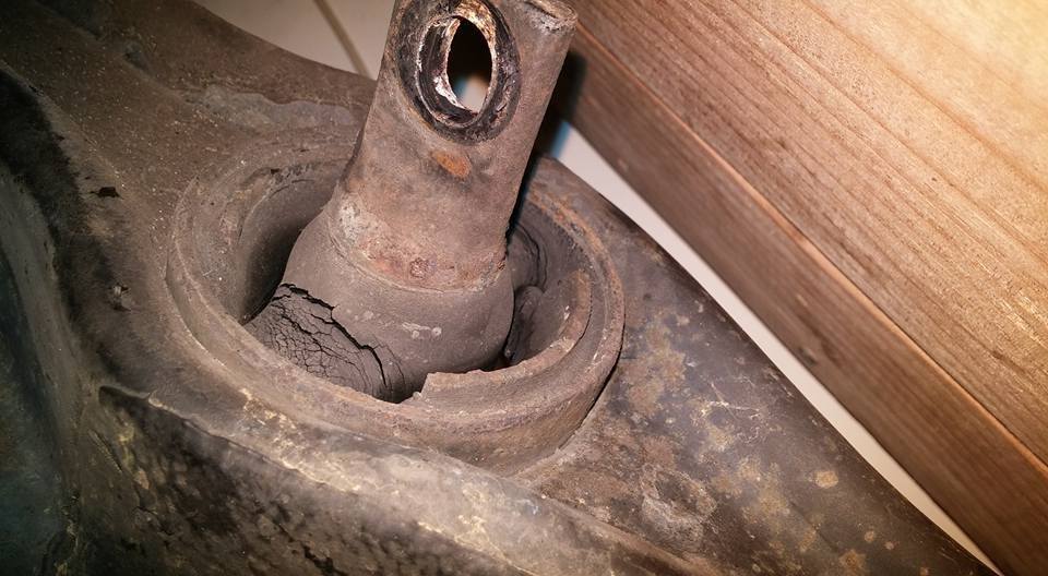

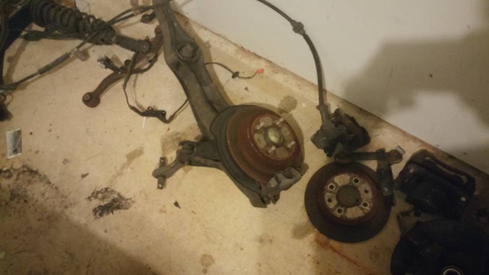

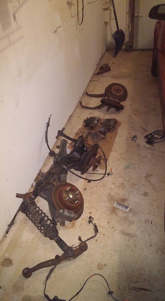

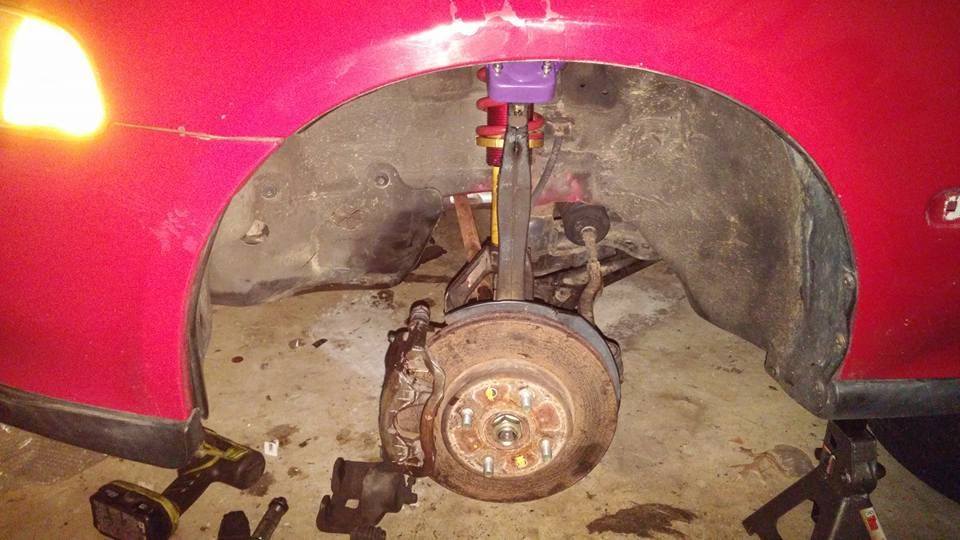

With the racing season over, I began tearing down the Civic so that I could put the new suspension on the car. I put her up on jack stands, I took the wheels off, took the front, lower, and upper control arms off, took the knuckles off, took the rear trailing arms off, and I plugged all of the brake lines to prevent brake fluid from getting all over my floor.

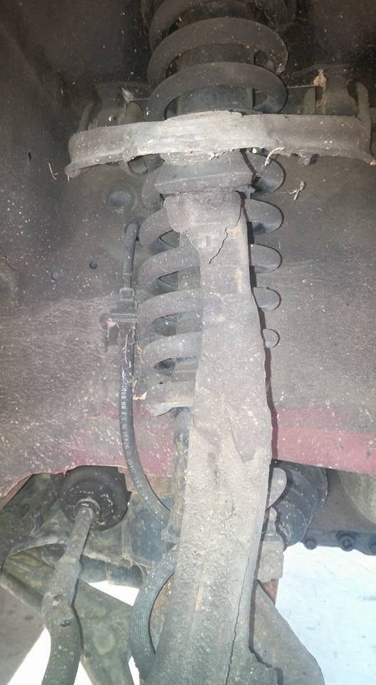

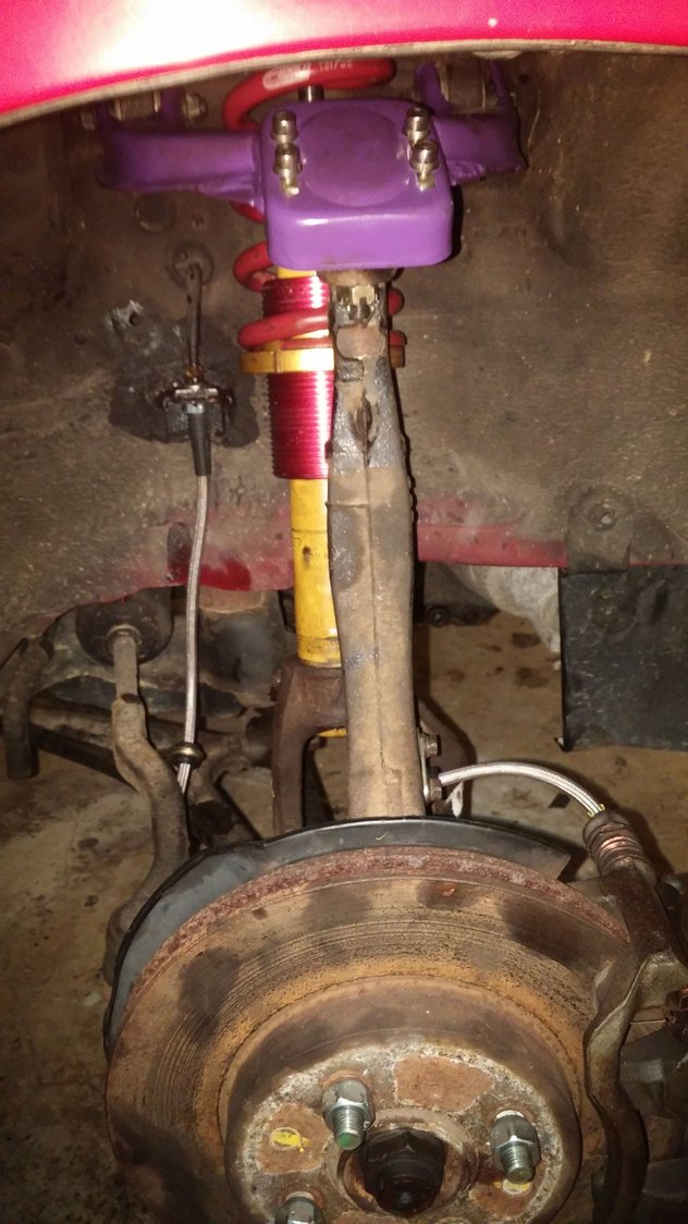

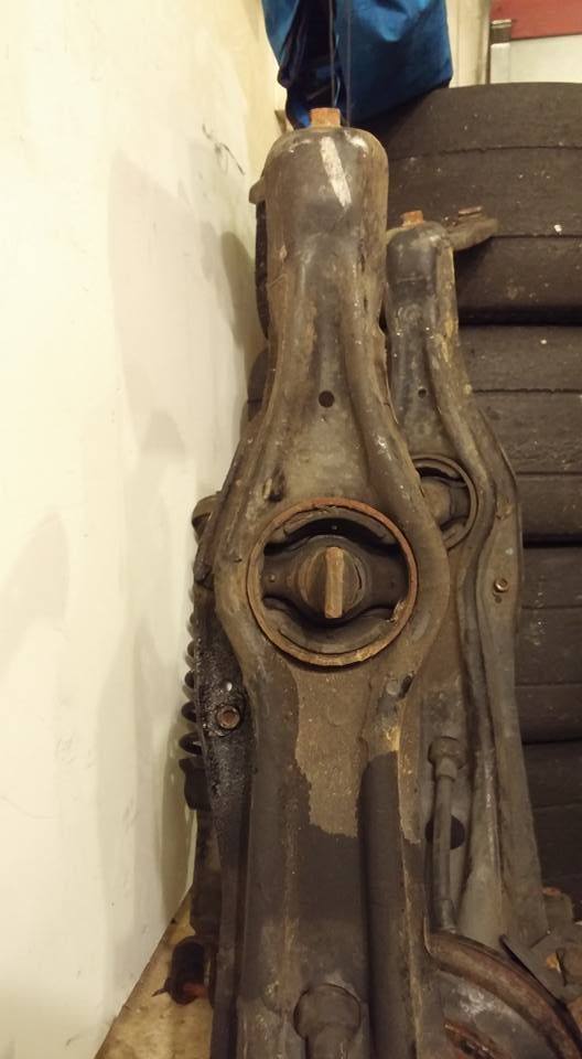

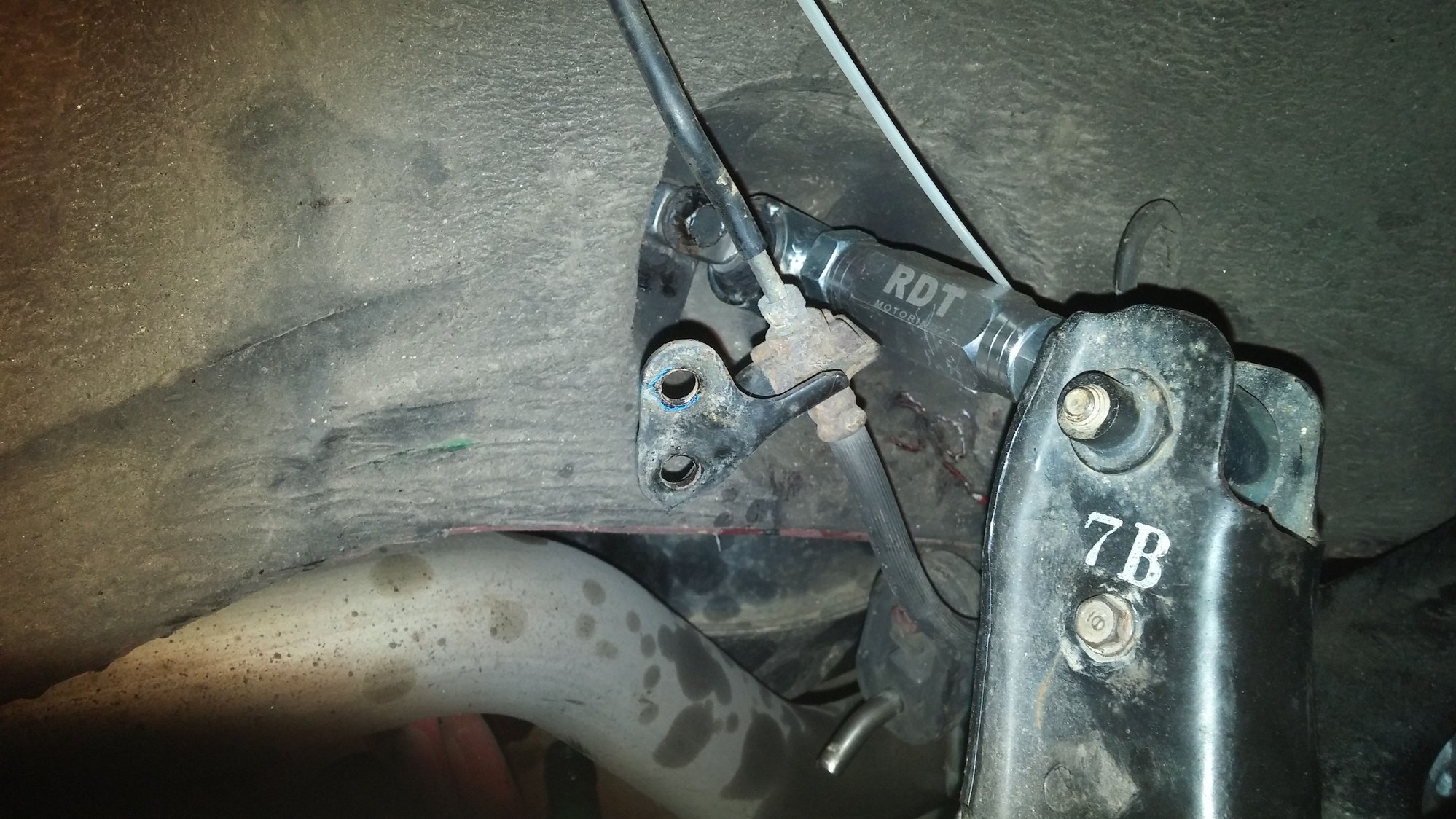

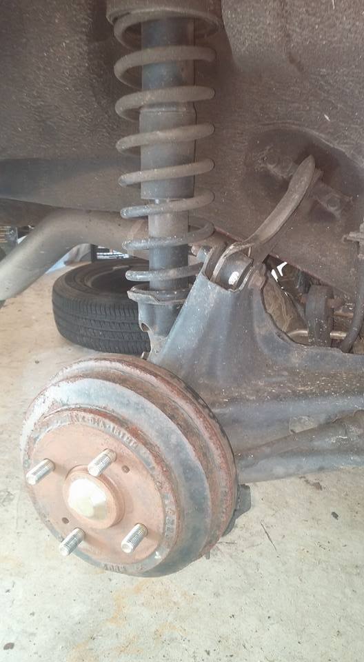

Here are some pics of the condition of the suspension before I took it all off. (Woooo, take it off!) ...sorry...
While under the car, I began inspecting for rust or anything suspect, since I didn't give it THAT thorough of a look-over when I first bought it...
After looking it over, my original sentiment was confirmed. The car was in great condition (and still is). I couldn't find any rot on the monocoque, I didn't see any rust that I didn't see before, and the only real issue was the rotted bushings (which is to be expected of a car this old).

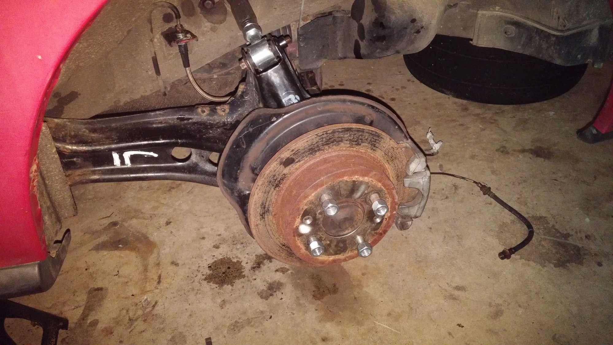

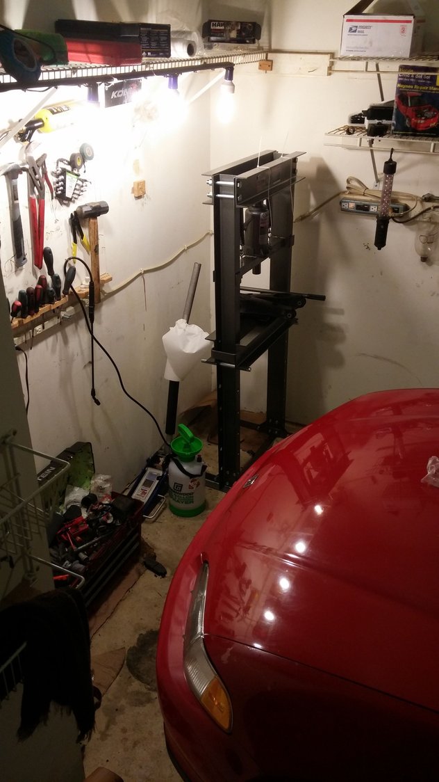

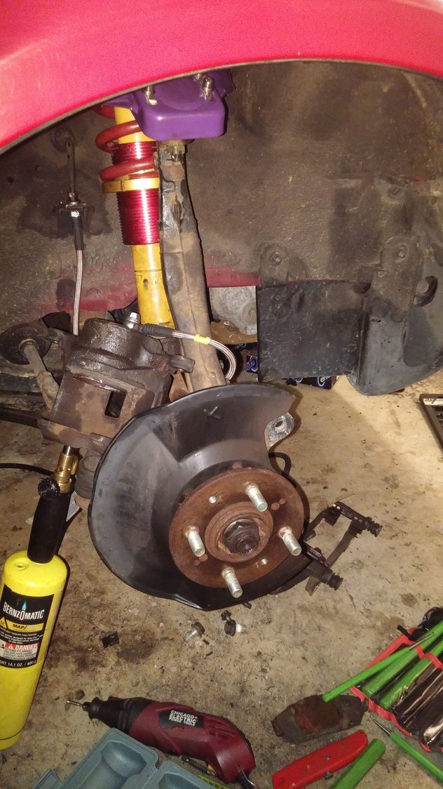

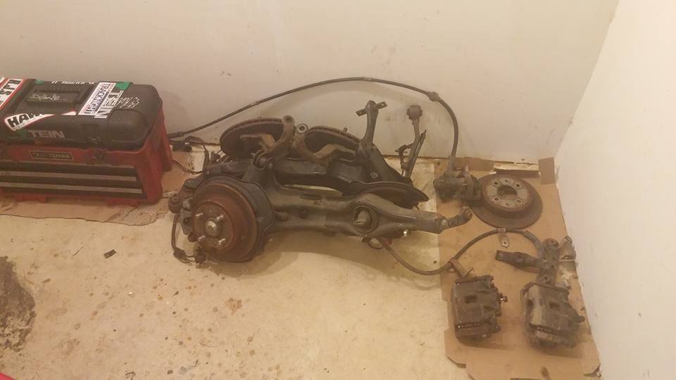

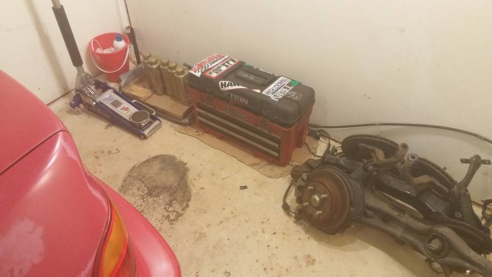

With the car on jack stands, and with my new suspension pretty much ready to go into the car, I started doing some of the dirty work. Here are some pics of the car with suspension components taken off:
Thanks to my good friend Joe who builds custom mega trucks and has his own bad-*** garage with a bunch of sweet tools, I had access to a 20-ton press and more. This allowed me to start pressing out my bushings.

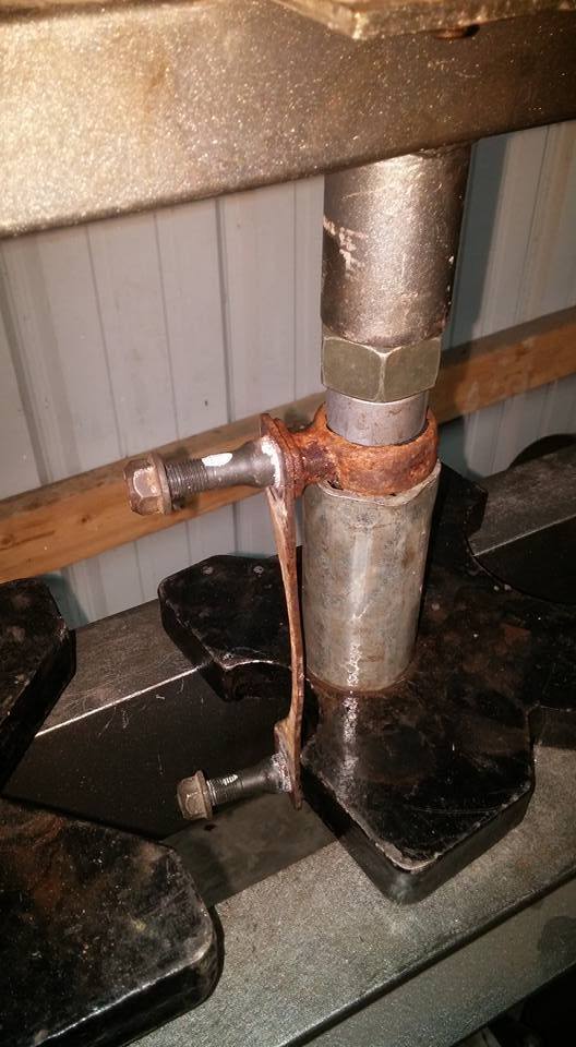

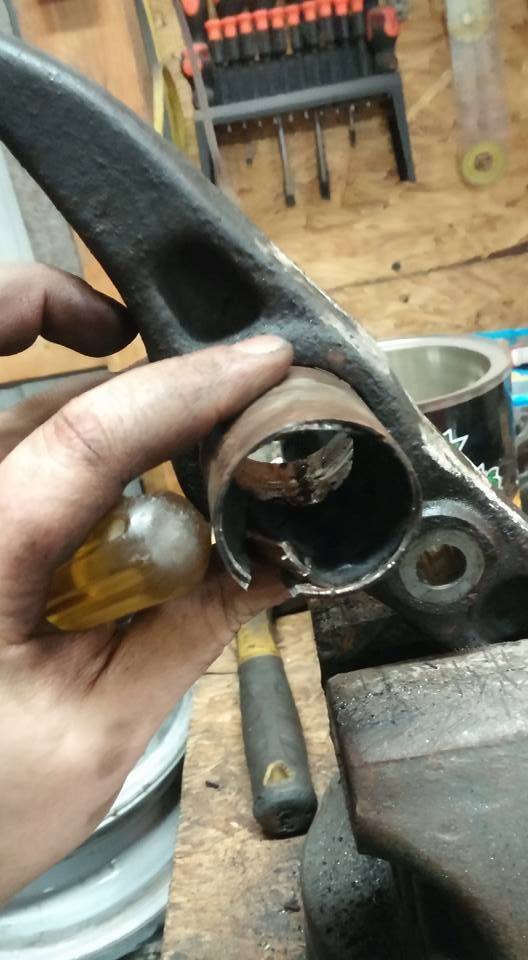

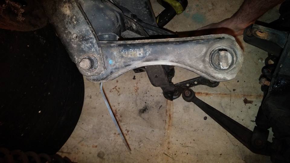

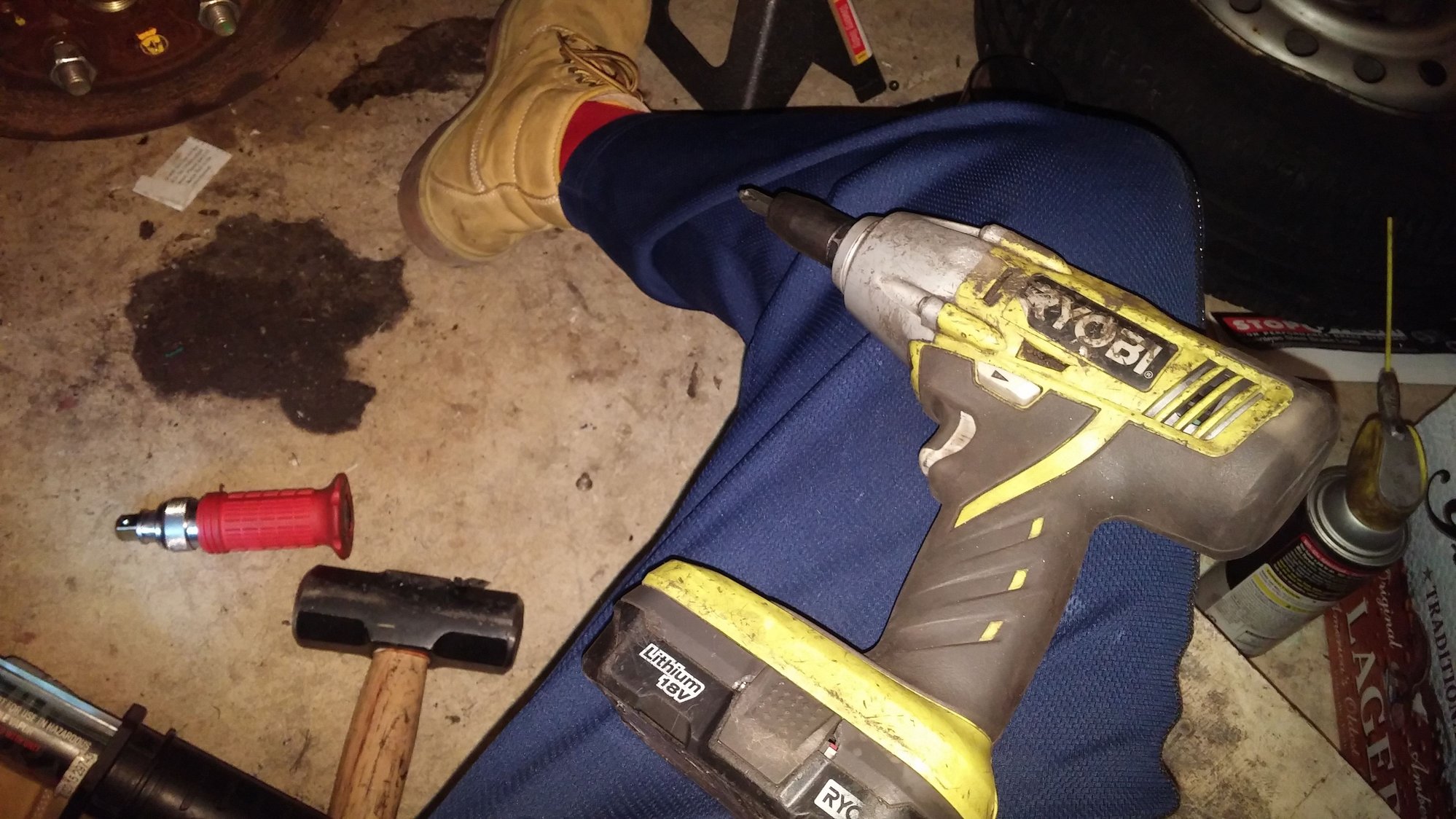

Now that you've listened to a shameless plug for my friend, check out the process I went through after I got the Civic up on jack stands! (Sorry again, lol)

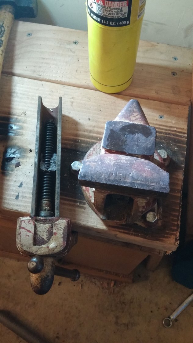

Here's me pushing the RTA bushing out of one arm with the help of my good friends oxygen and acetylene:

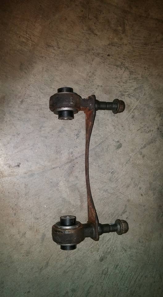

Here are some pics of the RTA's after the bushings had been pressed out and after I started removing various things to ensure I would have no issues with seized bolts in the future (Joe has an excessive supply of PB Blaster and a really good impact gun )

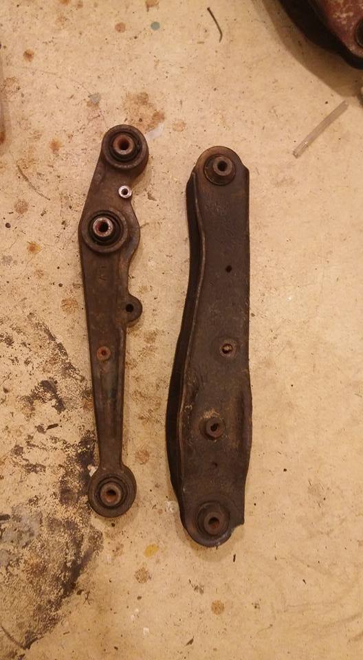

After pressing out some bushings, I sat down and started looking for ITR rear LCA's. If you know anything about the ITR vs. the regular Integras and the 92-01 Civics, you'll know that the rear LCA's are BASICALLY the same (slight differences in length and mounting point distances from the chassis, etc) for all of those models, EXCEPT for the Integra Type-R. This makes running ITR shocks and springs a bit difficult with a non-ITR suspension, if you know what I mean. So, I ended up picking these up for $100. Not an amazing price, but not too bad.

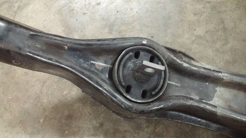

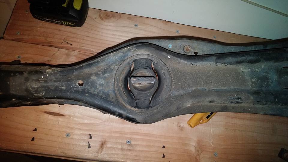

With my bushing kit finally ordered, I began pressing them in. If you know anything about installing bushings in Hondas, you know that the installs have to be done correctly. From what I understand, some instructions go as far as using the proper torque specs on bolts holding different arms to the chassis and etc.
Another thing that is of importance is the orientation of the RTA bushings with respect to the RTA and the chassis as well-- since incorrect "clocking" of these bushings can result in excessive bushing wear and odd behavior at the rear end of the car.
With my paranoid, misinformed ***, I also applied that same ideology to the compliance bushings for the front, lower control arms...only to realize that after installing these, these bushings move fairly easily. Here is the process for removal and installation of my front suspension components:
You can see that these bushings were worn, and cracked...in different positions than intended from the factory, out of the box...and ultimately not satisfactory for racing use...or even street driving:
Some of the bushings came out easily:
Some did not:
Here is the front, lower control arm compliance bushing installed on the control arm. Note that there are markings on it because I originally thought I had to clock them like the RTA bushings:
This is some of the math that I did to clock them, simulating full droop. In retrospect, this was pretty useless, but I think math is cool so I'm going to post it anyway lol:
Next, I installed the PIC Bushings into the upper camber arm mounts. You can actually install these at an offset for more or less caster, but I didn't want to play around with the caster since double wishbone doesn't need as much caster as macpherson strut (something I learned from the DC5:
For upper control arms, I bought some cheap eBay ones with adjustable slots for the upper ball joint. I will check the torque specs on these mounting bolts frequently and use Loc-Tite to ensure that they do not come loose during track days. From what I understand, whether you buy the $40 dollar arms or the $200 arms, they will loosen up regardless.
Maybe I'll switch to the PCI ones in the future to avoid these problems, but for now I simply torqued the upper control arms to the mounting bracket with enough force to ensure that they would not fall off of the car while allowing for smooth movement relative to the chassis.
Here is everything installed on the front of the car:

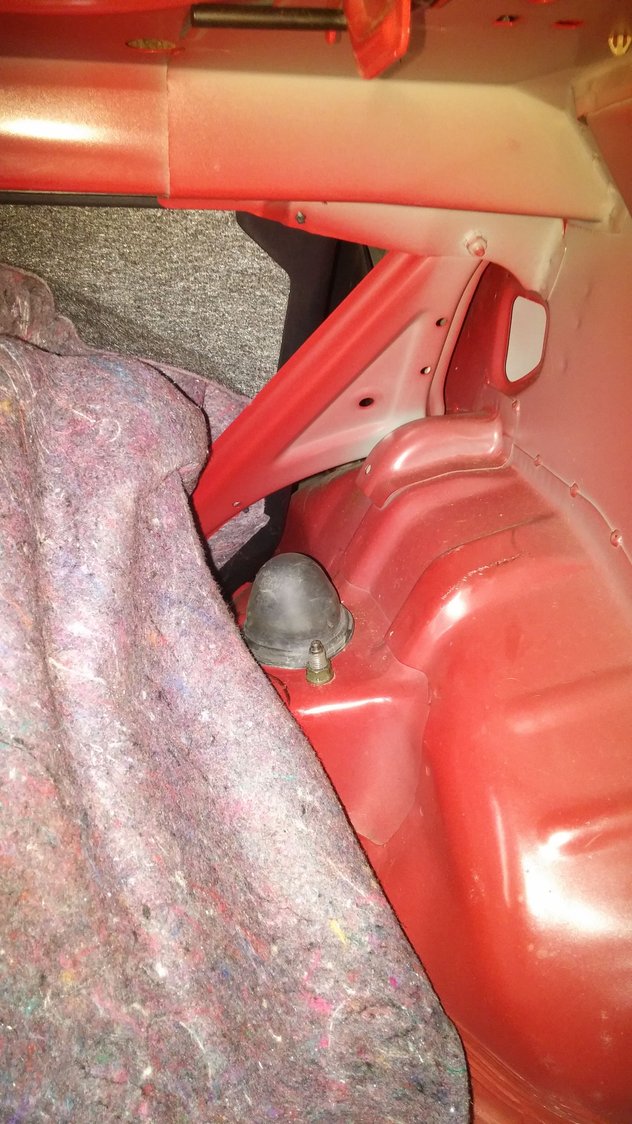

Paid $60 for this and put it in the hatch of my RSX:

If you recall, I said that the eyelet bushings on the ITR shocks were not replaceable with the PIC kit, so I had to custom-make delrin bushings for them. Here is the process of me pushing them out, measuring them, and the drawings I got back from Avant Mfg:

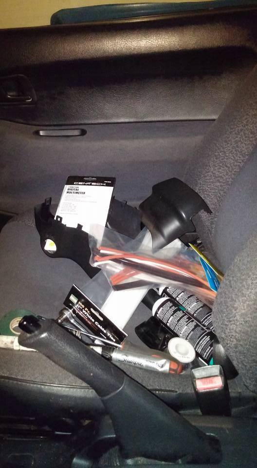

I also began putting together my alarm system from Viper. I didn't want anything crazy-- just something to tell me if people were messing with my Civic by making loud noises. I also wanted to make it very stealth, but I am not going to share details since it's an alarm system for a reason...kabeesh?
Clearly someone has been in here before...:
As of now the alarm system is completely finished and I am waiting on the bushings from my friend. I already have some ATE Gold brake fluid, stainless lines, and a 15/16 MC. I may start looking for ITR sway bars and an Integra steering rack to shorten my lock-to-lock steering ratio from 4.0 to about 3.2.
Here's what the interior of my car looks like ATM:

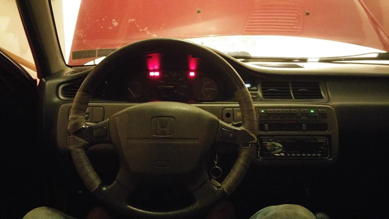

I used tennis racquet handle tape from Wal-Mart and secured it using cut-in-half electric tape strips for now. When I get a proper harness, seat, and roll-bar setup, I will look into an actual aftermarket steering wheel. For now, however, I will save money here and get good grip out of the wheel. A good Subaru friend of mine did this before a track day and I loved the feel...so now I am trying it on my Civic.
Anyway...keep in touch to see the rest of the build...again, this is meant to be a simplistic build...but I am trying to build a fast, reliable, competitive, cheap car and I think that this Civic is one of my best bets...

So, my friend Eric at Avant has been swamped with work on the delrin bushings, but he said he would do them when he has spare time even when I told him he didn't have to do them if he didn't have the time.
In the meantime, I do still want to finish my project car, so I pulled the trigger on some HardRace Hard Rubber Bushings for the ITR LCA's and on some shock eyelet bushings for my Integra shocks.
HardRace inboard and outboard ITR Rear LCA bushings:
P/N: 6389--TYPE-R
Link: Hardrace Rear Lower Arm Bushings 97-01 Integra Type R - 6389--TYPE-R - BuyHardRace.com
Koni ITR rear shock eyelet bushings:
P/N: 52622-sr3-003
Link: Acura Parts @ AcuraAutomotiveParts.org - Genuine Acura OEM Parts from Acura Carland
I also have acquired some brake parts that I need to install while I am waiting on these damn bushings! So impatient! Here is my 15/16 MC and stainless brake lines awaiting installation:
And while I have been idle, I also bought this sweet vise and installed it in my garage! It's a "Dunlap" vise made in America.. Apparently it's Sears' old economy brand from around 1930-1940. Paid $40 with shipping!
And since we're all still waiting for the car to be put back together, here's another shot of the Civic from that one autocross I did with the Philly region:
Again...SO IMPATIENT

I have some Nitto NT450's that I purchased for my GSR blades when i began building my engine. They are roughly 5 years old and have approximately 90% thread left.
Just know that old tires don't grip as well basically. They handle heat differently too. Make sure that the tires aren't cracked at all, but keep in mind when you're going for 30 minutes straight on the track, tires and brakes are the last thing to cheap out on.
Protect your investment, yourself, and those around you by making sure your tires are safe.

So update. I got my bushings for my ITR control arms yesterday and today I decided I would press them into the control arms. First, however I made sure that they would fit in between the chassis mounts and that they were the correct diameters.
I decided that I would try to use my new vise as a press to get the bushings into the control arms.
I tapped the bushings in at first, then I began pressing.
I decided I needed a little more force to simulate tons of force pressing the bushings in...and given that I had used my dad's old vise to press in and out ball joints before, I decided to do the same with this vise and a cheater bar....
Bye bye new vise -__-
So, I decided to see if my friend Joe could lend me a hand, but as luck would have it, he was busy...so after months and months of borrowing this guy's press, I decided to just buy my own.
Honestly I'm not sure how worth it this press will be in the long run, given that I don't want to **** my neighbors off with banging and loud cracks of rust breaking off of bearing sleeves while they're being pressed out. However, it made me very happy tonight, because I was able to do my work in my own sanctity.
What a blessing.
I quickly got to work laying out the bushings and pressing them in.
You will see that one end of these bushings is fatter than the other. This is because one side of the control arm has a smaller bore than the other for the inboard and outboard holes.
HardRace really got the fitment on point with these bad boys. I wish I purchased them from the start, despite PIC's astronomically greater customer service!
Finally, here are all of the bushings pressed in:

So, I didn't get my shock eyelet bushings, but I did start putting my suspension on my car.
When putting disk brakes onto the Civic, it is necessary to have the correct hydraulic and hand brake cables to replace the old ones with.
Given that I never took the parking brake cable off of the car and I just cut it where it connects to the trailing arm, and given what I just mentioned, I figured I would begin by removing my parking brake cable.
Then, after crawling around under my not-so-high-off-the-ground civic and busting my ***, I started prepping the suspension from the GSR donor car to go onto the Civic.
I had to take the parking brake cables off of the rear calipers, slide them through the rear trailing arms, and Mark everything driver side and passenger side.
I also had to tighten a wheel stud onto the hub of one of my arms since it was loose.
I used some left over koni hardware to get this job done!
Finally, I got all of the bolts into their respective threads after harvesting some of the bolts from the OEM trailing arms using some heat (torch) and a breaker bar, and I mounted the right, rear suspension.
When I finally get the suspension in and both shocks installed, I will torque all of the bolts down for the bushings, AFTER I find the ride height I desire and after I align it.
I'm coming close to crunch time as I only have a month before racing season starts!

Anyway, today I finished the following:
*installed stainless steel brake lines all around
*bled and installed 15/16 master cylinder
*and I finished installing BOTH rear trailing arms and LCA's
It doesn't sound like a lot, but I do this stuff only on work days after I get home since I am with friends or family on the weekends.
It's one of the reasons I decided to make this build so cheap and simple.
Anyway, here are some photos of the installed suspension and the installed stainless lines:
And here is my "bench bleeding setup" lol:
I took some vacuum tubing, inserted it into the holes, sealed the edges where the tubes met up with the master cylinder using some grease, looped them back into the mc reservoir, and zip-tied them to the reservoir and got to pumping the mc with my hand.
Here, you can see the size comparison between the original (13/16?) mc and the 15/16:
Here it is installed in the car:
Tomorrow, I will hopefully finish the shocks if the bushings come in.
If the bushings are slightly smaller, they will need to be welded into the shocks.
If they are slightly bigger, they will need to be ground down.
Hopefully they fit perfectly and I can get this car on the ground.

Tonight I got my OEM replacement bushings that were supposed to fit into the eyelet where the rear ITR shocks mount to the LCA. Unfortunately, the eyelets on the Showa shocks from Honda probably don't match up in size to those on the konis.
As a result, my bushings did not fit, and I had to get creative.
Remember how I said I had to weld in the PIC bushings to the rear camber and toe arms? Well, I had to press cheap, eBay bushings out of those cheap, eBay arms to do so.
Those cheap, eBay bushings, however, never got thrown out...and when I got to digging in my box of stuff, I found out I still had them.
I also found out that they fit the koni shocks!!!
The interference fit was a bit snug, but other than that, the fitment would work great.
Next, I had to figure out which bolts to use for the shocks on the rear LCA's.
I knew that the bolts for the EJ2 Shocks were too long, so I could have used a washer to fix that problem, but I only had one of these bolts left over.
I knew that the toe arm bolts were the correct diameter and thread pitch, but they did not have enough thread to make me feel comfortable with putting them on such a crucial part.
However, the camber arm had a perfectly sized bolt in terms of length, and the majority of the bolt was smooth where the shock would sit. So I said whatever, and used that bolt to mount the shock to the arm.
The bolts in the middle are the ones I chose:
I compressed the Shocks and held them tight with some zip ties, then mounted them. First the eyelet bolts, then I decompressed the Shocks and allowed them into the rear strut tower and tightened them down.
Tomorrow, I will probably try and get the car on the ground

Big news for Chelsea (my Civic). She's on the ground finally! It wasn't easy, but I got there with some patience and care...
With the rear suspension fully bolted onto the car, I had a couple of tasks ahead of me. Firstly, I had to route my hand brake cables to the new trailing arms and up through the cabin. I decided to use my cables that came with my Integra arms and it wasn't easy..
Below you will find a shitty picture of how I routed the brake cable through the rear trailing arm:
After figuring that out, I bought new hardware, new gaskets, some rtv sealant, and I mocked my midpipe back up to the car.
I had to take it off to get to the brake cables.
When I went back into the car to try and reconnect my parking brake cables to my hand brake lever, I ran into some issues.
There is a metal bracket that threads onto a metal stud that is riveted to the ebrake lever. When you get the brake cables into this metal bracket, it allows you to actuate the rear brakes by pulling on these cables with the brake lever.
Below you will see the bracket I am talking about with the cables installed:
This is also where you tighten or loosen the cable to make your ebrake tighter or looser.
My problem was that I could not figure out, for the life of me, how to get these integra brake cables into the bracket with the bracket still attached to the brake lever.
So in my mind, I had to order the correct brake cables that I was told to order during a discussion I had with someone who completed the build before-- 94-99 integra sedan cables.
However, after I ordered them on the weekend, I decided to give it another shot and install the brake cables a different way while I waited on my shipment. I did this on monday, after I got home from my girl's crib.
It turned out that if I attached the bracket to the ebrake lever, unbolted the ebrake, and pulled the cables by the lever until I could bolt the lever back to the chassis, I could correctly adjust the cables.
On Tuesday, I got my first shipment of rotors and rear pads from **** Auto, and tire the rear rotors and pads on to test my ebrake cable.
And what do you know, the integra cables worked fine. Whether they work as well as an oem setup,i am not sure, but they clamp these rotors down good and they stopped the car from rolling when I got her on the ground.
Next, I had to go up front to get my rotors off. Since the asshat before me decided to install the rotor set screws, I had to give them a little love with a BFH, a MAP gas torch, and some penetrating spray. Did I mention, I needed to give the screws a little love?
So, I got my centric rotors on the front, my used pads, and I bolted everything together. Then I checked the thread engagement on my studs (over u turns, happily) while installing my wheels to see how she sat on the ground!
Forgive my pictures. My garage is tight and its hard to get good shots of my car.
Now I have to decide whether I want to run these slicks and buy a set of street wheels and tires, or whether I want to do away with the slicks as a whole and run rs3's.
I also have to set ride height, align the car, bleed the brakes, buy more ate gold brake fluid, and buy dtc60 pads, and I should be done if all goes well.
