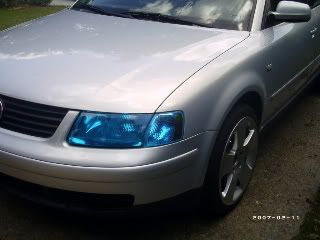

mine were real bad on my volkswagon so i sanded them and mixed house of colors oriental blue with clear
