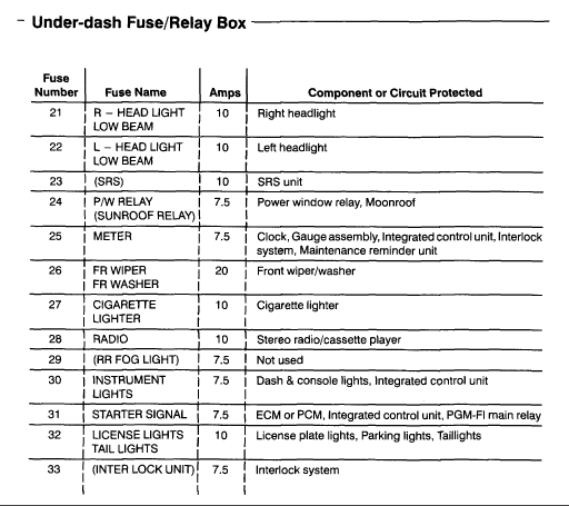

Check #20 or
Check your under hood fuse box and check fuse #32
