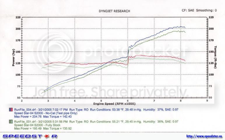

I will
here is a F22 stock vs the same F22 with test pipe
