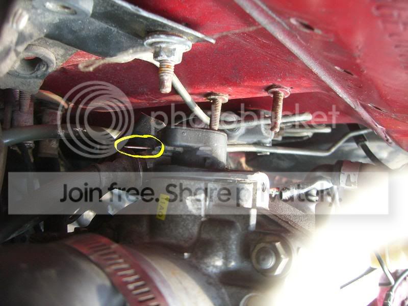

ok i was throwing code 7 and i dont understand y..i didnt have it b4 but i guess i ran it hard and it popped up..but now it doesnt go away.i searched but didnt really understand..some1 wrote that i should check the wires that it might have a bad wire or ground..i took a picture nd it looks like my tps is not on good..its from a d15 cuz i cracked my h22 one..also is anything supposed 2 plug into the tps or should it just be chillin on the tb..thank you all
what is that little pin thing i circled?

Are all 3 prongs still there? If so, put your plug back on and just use electrical tape to keep it held on

i took a look at it just now and i only have 1 there so i'm going to have to replace it. is there a step by step anywhere that shows how to remove it and install a new one thanks

I don't believe they can be removed. You'll probably just need to get a new throttle body, cause for the price of a new sensor, you can just buy a used one. What type of motor do you have, cause I can probably find a used Throttle body at my GF's, dads shop for cheap

It can be removed but like he said you might as well find a tb that has one intact. My friend and i broke his during his swap. Luckily we had one from his h23 which was identical to the h22 one. to remove it we had to drill out the screws cause they are the non removal type. And it has a little gasket. When we finally got the other one on it was reading backwards and throwing a code. In the end he found a used tb on ebay with a tps intact still and it now runs without the code.

i have an h22..if u can do that 4 me id be thankful..also i am goin 2 the junkyard now to find 1..
