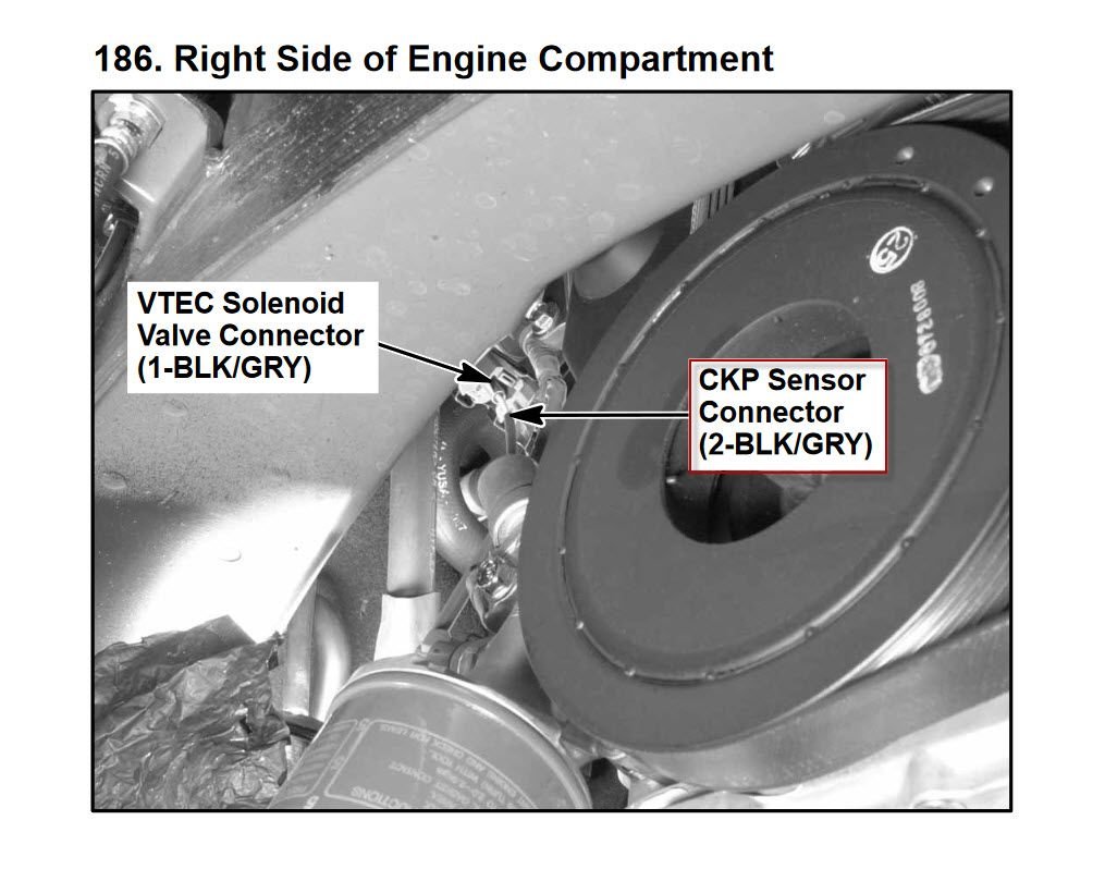

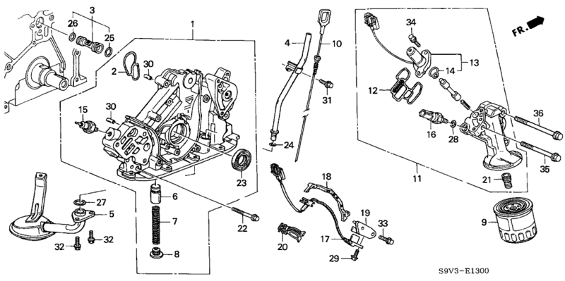

It is located next to the oil pump. Behind the crank pulley and lower timing belt cover. Part # 17 is the CKP sensor. In post # 6 of this other thread are some photos of the actual CKP sensor once the crank pulley and cover are removed. https://www.piloteers.org/threads/oi...0/#post-379569
The connector to the CKP sensor is visible without removing anything.
