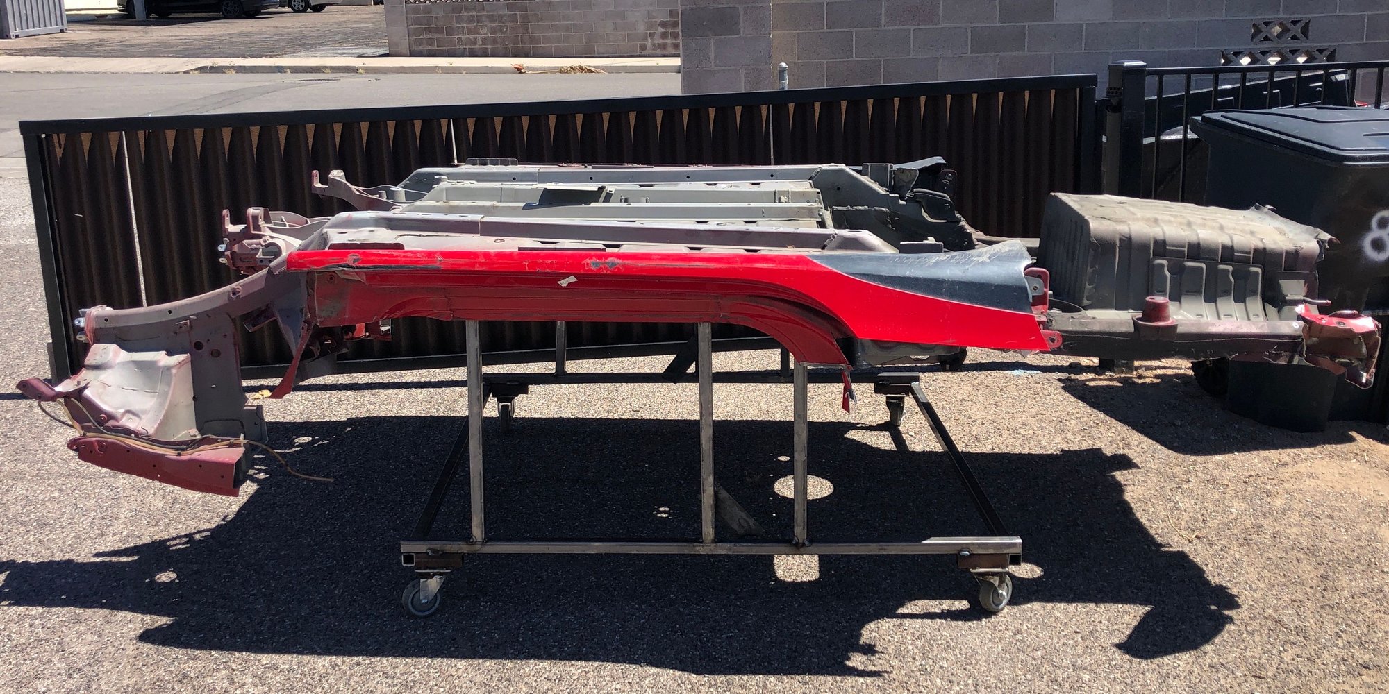

So this build thread is turning into my diary, I have come up with a few ideas since this build has started and changed my mind a few times, bought a second car and stripped it clean so I can put one together the right way (got it cheap too).......For my true Insight dream build I just bought a K series AWD 5 speed manual transmission...... but Im a desert guy, remember, I'm going to run 28" off road tires. I cut the parts car chassis into a chassis component jig and will be running a high compression K20a3 hybrid turbo motor with about 200WHP which doesn't seem crazy but it will be at really low RPMs and an efficient and smooth cruise as this will be for long distance driving while towing teardrop on and off road and efficiency still being important. This is a preview post but the car will have a much better build thread for sure..... as for the commuter insight, Im sticking with the Kpro, the manual trans and aluminum flywheel, switching to a shorter wider but all season tire and fixing rear offset with 2001 Accord V6 +55 15" 5 lug rims (for those that use 195s with 23mm 4to5 lug adapters, that's your offset and tire width). Turbo is going away and a long tube header will go in. Since the intercooler stuff is all going away I might redo the A/C fan (make a pusher) and build a steel long tube drop down intake manifold, will be also using a TB from a D17 civic, super cheap. Also Im going so save the Koni RSX struts and go back to stocks but keep the GC coilovers on all 4 as well as the GAZ out back. This car should wrap up rather soon as I finally have the time and money to put back into my car and I can finally do it at home. While it might not be as exciting without the turbo it should still be relatively quick and get good mileage and run forever. then I can get on to the fun stuff.

Default Re: Build thread-1G Insight w/L15a Fit A/T ultimate commuter
wow, niice trailer
