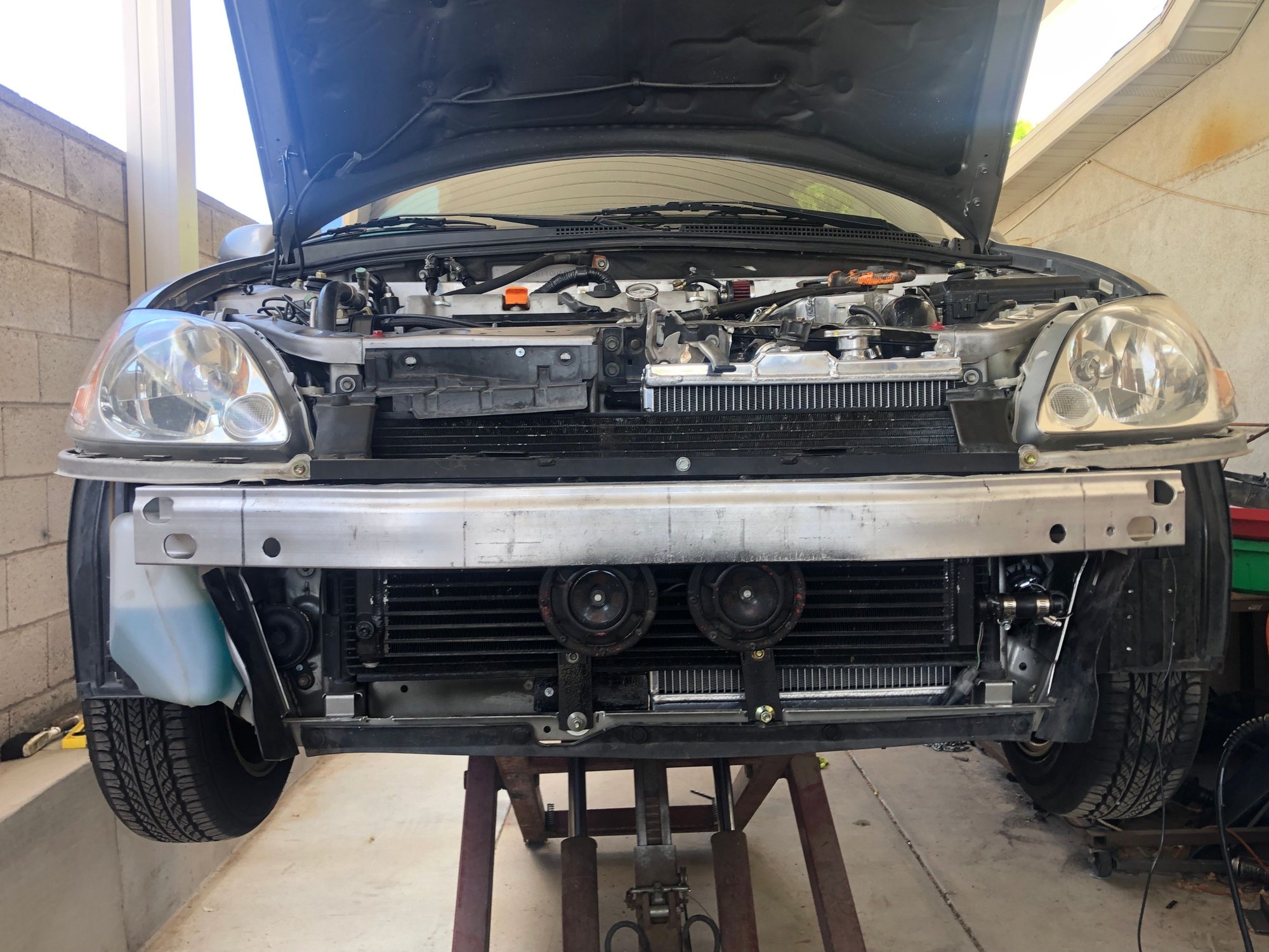

Summer heat wave cooling "R&D", after trying a new aftermarket OEM replacement we hit 115°F days and car struggled, in the end I went with the 2858X CSF Civic dual core which comes with SPAL fan, I upgraded it to the 1325CFM unit, Also moved the heat exchanger up some to give radiator a bit of direct air..... now, it runs very cool even on the hottest days!!

What are you intake temps like with that water to air? I have one on a 7MGTE but no way to monitor it on that 100 year old ECU.
