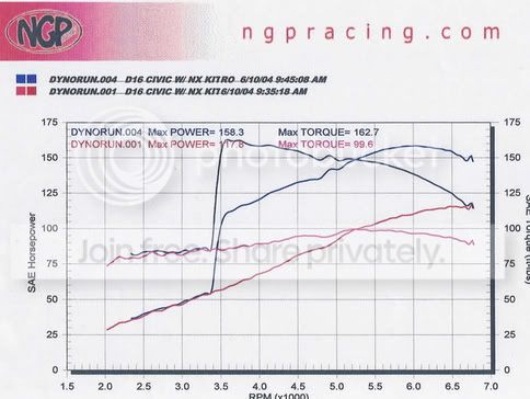

Nothing else will deliver INSTANT torque like nitrous.
Just look at this curve:
It's a D16Z6 (stock) with an NX 50 wet shot:
