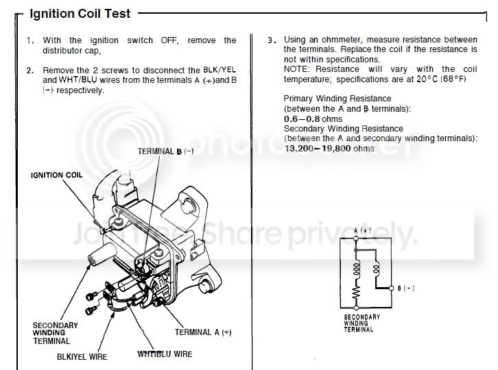

Is the CEL on?
Both the Blk/Yel wire and Wht/Blu wire attached to the coil should be hot. Pull out the coil and do resistance tests on it (see diagram). Also remove the igniter unit and have it tested at an auto parts store.
