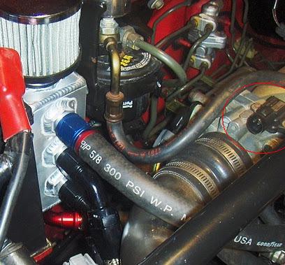

vacuum runs from the intake manifold. Follow all the lines and try to trace back to the sensor. Also are there wires plugged into the oem sensor? if so then im betting you dont have a 3bar.
see this pic of my bay, i still have the stock map in place but the wiring has been removed and re-wire to the 3bar
this picture helped a lot because thats how he explained how mine was but i didnt even pay attention to the wiring where did you mount yours?.. no my stock map is still plugged in... does a gm 3 bar look a lot different than a stock map sensor? im gonna dig around my engine bay but i just swapped turbos and did cams.... i swear i would have noticed a sensor hanging around... who knows...
